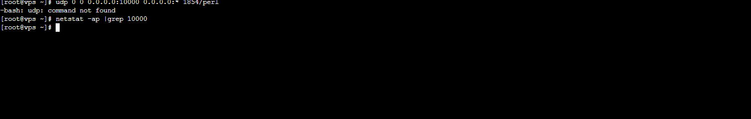

that was the command to see if something else was on port 10000
Thatâs the expected output.
But thatâs based on a guess about what the unseen error might be based on the truncated output.

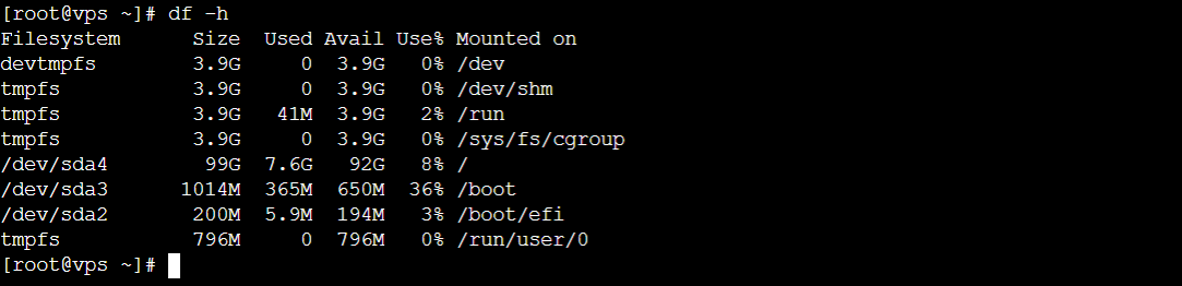

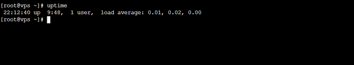

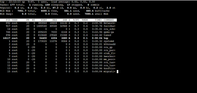

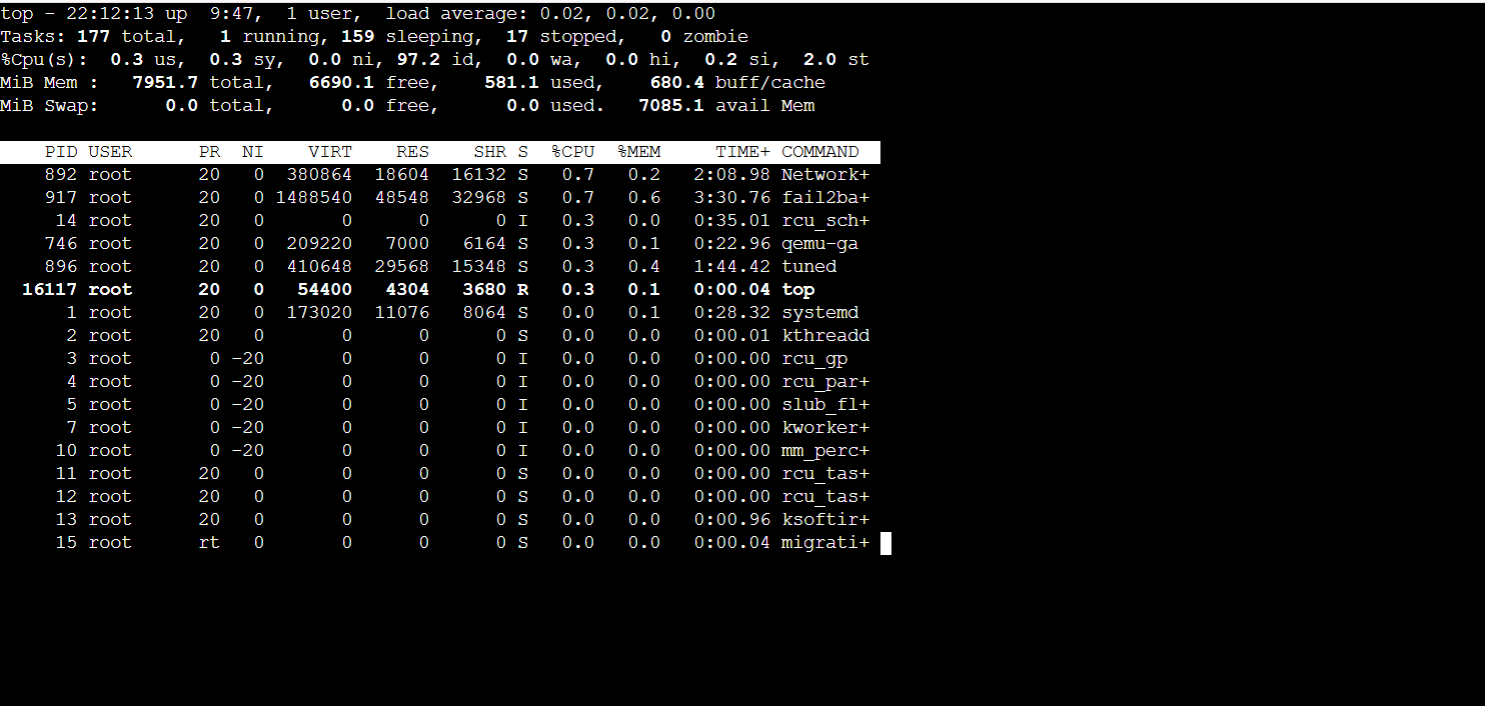

I donât see anything terrible happening there. I donât see any evidence of catastrophe unfolding from the perspective of memory or disk space or CPU. So I canât even guess why restarting Webmin would time out.

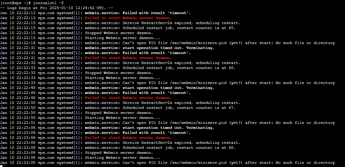

Is anything showing up in the journal, at all?
journalctl -f
Just watch it for a little while and see what goes by. Maybe thereâs a clue about what is screwy about your system.

We do see truncated error.
image885Ă180 68.3 KB
My guess is failed to bind and could not listen. I think he OP is using a web console for access so CTL - isnât working to see the full output. Thatâs as much as I can distill out of this.
We already saw the full error in the journal they posted above. The error is not useful. Itâs a timeout waiting for Webmin to start and place a PID. We already know Webmin isnât starting. We need to see the actual Webmin log entries to know why, and thatâs somehow not being written.
Oh, but I guess the âFailed to biâ bit might be showing something already listening on 10000. But, netstat showed nothing.
