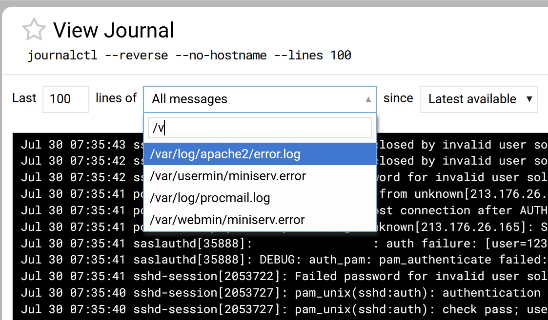

With the Webmin graphical interface, I do see a “journalctl --reverse --no-hostname --lines 100” as a command.
It’s just that I’d like to have the pulldown menu show the newly added logs now that rsyslog has been installed (especially mail.log which I usually use this panel for).
I did try to add ‘Extra log files to show’ and added the mail.log. Restarted Webmin and tried again. But still not showing the extra logs as options in the filter box.

Ha! That was it! I just needed to add each additional log on a separate line. Yay!
