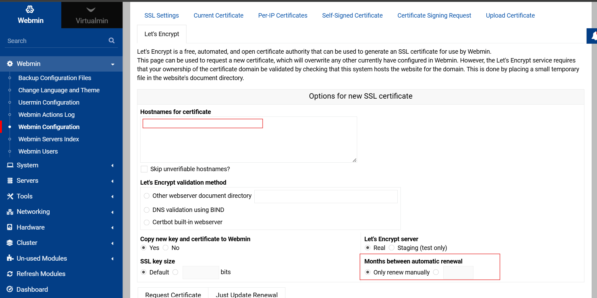

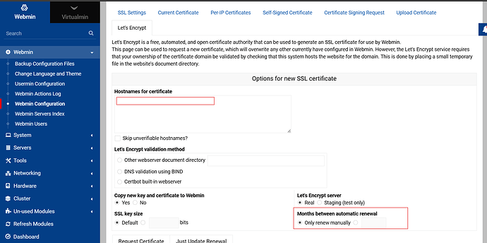

Hi guys, I have just installed a fresh Webmin/Virtualmin on my new Ubuntu server. I see that the FQDN when installing Virtualmin has been SSL signed successfully, but I don’t know whether it is set to auto-renew. I just look at the Webmin → Webmin Configuration → SSL Encryption but I am not sure that I have to set the option Month between automatic renewal to a number or leave it as default. Please help me, thank you guys so much!
Clarify: I installed Virtualmin with the domain name I defined in /etc/hosts (test.domain.com). Then I can access to it via https://test.domain.com:10000 successfully, so now I want to know if this domain is auto renewal.
are you using virtualmin ? if so setup the SSL certificate using virtualmin rather than webmin, you don’t need to set this in webmin if your domain is correctly setup in virtualmin
yes I am using Virtualmin with different domain and Webmin with different one. I see in Virtual the doamain1.xyz.com has auto renewal enable. But in Webmin SSL configuration , domain2.xyz.com I can’t see SSL auto renewal (I access webmin via https://domain2.xyz.com:10000 and create Virtual server in Virtualmin with domain domain1.xyz.com)

Virtualmin Let’s Encrypt management is independent of the stuff in Webmin. If you have Virtualmin, use Virtualmin for Let’s Encrypt, and login to Webmin on any domain managed by Virtualmin. (If you have an automatically created domain for the system hostname that Virtualmin made during the installation, that’ll also probably work, but you never need to use the system hostname for anything once you have Virtualmin domains).

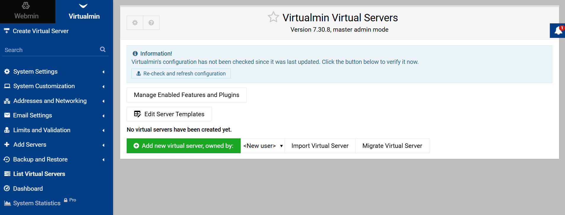

Currently I have no Virtual servers so I just concern about the “automatically created domain for the system hostname that Virtualmin made during the installation” . Because I use that domain for login to Webmin/Virtualmin to manage the server so I want to make sure its SSL config is auto renew.

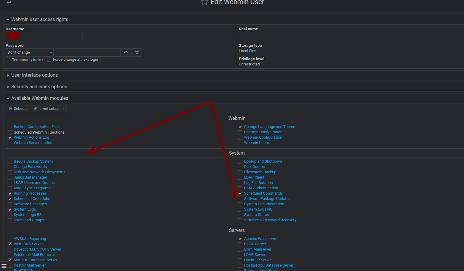

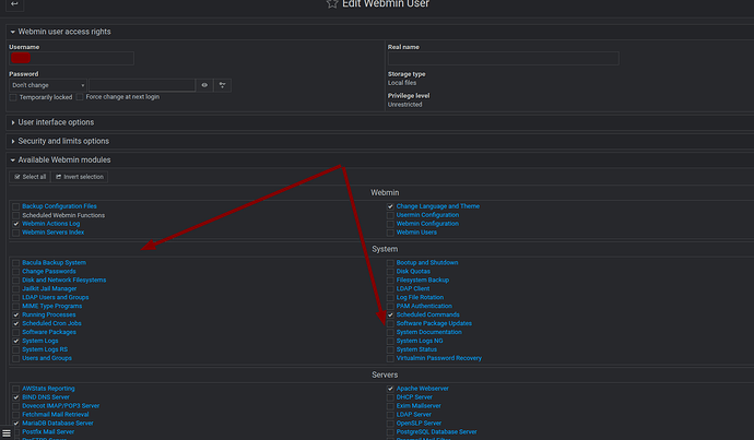

It does not matter, if you use the system hostname or any hosted domain to access webmin/virtualmin. If a super user logs on they will have access to the system, unless you just curb their privileges to whatever modules you see fit
normal users don’t even see the webmin menus to test this out try this
to see what a domain admin can see, you appear to just be over complicating a very simply thing

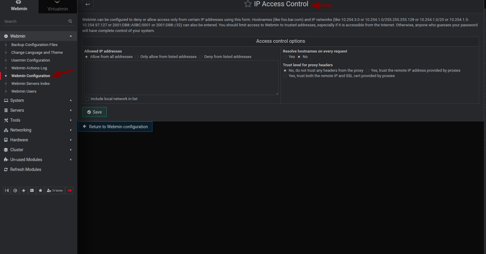

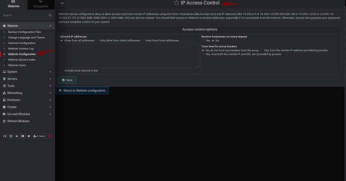

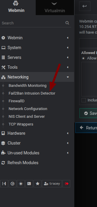

what harm can it do ? Webmin is pretty robust with it’s security, but if you also set the fail2ban webmin jail anyone how tries to login with incorrect credentials gets banned from the server.
You can also restrict the IP addresses that can access Webmin by
you can even restrict allowed users to certain times of the day or days of the week that they can access Webmin.

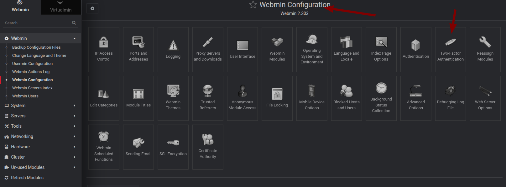

Or add 2fa to the

If you installed virtualmin via the install script fail2ban will already be installed for you, you just need to configure it.
and 2fa is setup here
