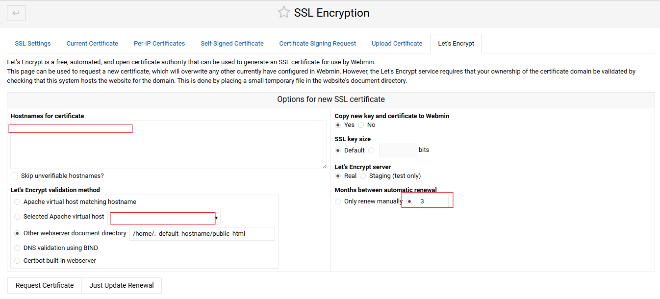

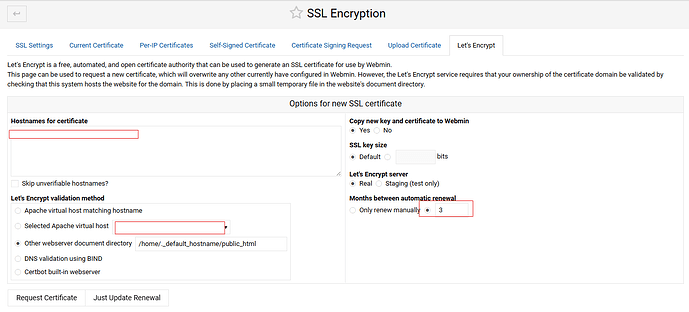

I think when I changed the tick box and the Months between automatic renewal form none to 3 and clicked Requets Certificate, it might create a domain as my hostname but I see no Virtual host created
Can you please help me check that?
where is this page you show in the screen shot ?
Edit -
found it .. it’s in webmin, this should not be used, for the best experience you should use virtualmin for this, as explained quite a few times

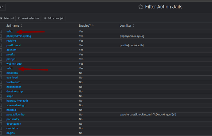

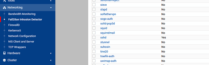

Hi, there are two sshd here in fail2ban, which one is correct? Thank you
You need to explain that? I only see one. Not sure what sshd would be an issue for you problem as well.
I have 2, 1 being the data from the default settings and the second from the config files, this may vary from distro to distro
I see that they all have the same config so they may work as all
yes they do work together
