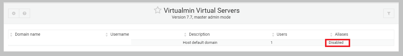

How can I make it so that “Aliases” in “List Virtual Servers” shows as disabled?

I don’t need it and it’s confusing Postfix when it comes to relaying. I’ve read here before that there’s a way to disable it, but I don’t want to dabble to deeply in the perpetual complexity that is Postfix configuration. I’m having issues with my catch all stealing mail from all other addresses and this is the cause.
So delete the catchall, but I’ve tested a catchall and normal mailboxes still get there mail.
please post your /etc/postfix/virtual

I can’t replicate the quirk now. It’s ‘just working’ The only thing I am doing different now is doing a Debian 11 non-graphical expert install and omitting everything from the install except that which I can’t deselect.
Then I install wget, download the virtualmin install, run it and voila, the catch all is working properly.
Before, I was using Ubuntu.
