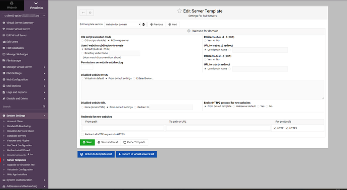

I have the template set up like this:
  1. Server Templates > Settings For Sub-Servers > Website for subdomain > These options have these values:
[Redirect webmail.${DOM}] no
[Redirect admin.${DOM}] no
Then i saved and created a new child server, then the new subdomains, all of them, are created again.
When creating a new subserver i make sure i select the template (the only one available) like this:
Could you please guide me a little bit more in detail, how i can do it?

So the admin and webmail sub-domains can be turned off in the server template already, at least in theory. However, it looks like the real issue is that for sub-domains that setting isn’t being respected, at least when using Nginx.
@Joe, yes, I can, and it does seem like a bug!
It works both in theory and in practice! We recently fixed it, I remember it. @dubansoft Please make sure that you have the latest Virtualmin Nginx 2.36 plugin version installed!
It also worked fine for me when a template for Sub-servers wasn’t saved (inherited from Default settings). After it was saved manually, all options were correctly applied when a new virtual server was created, even if the options in the default and sub-server templates were different.
