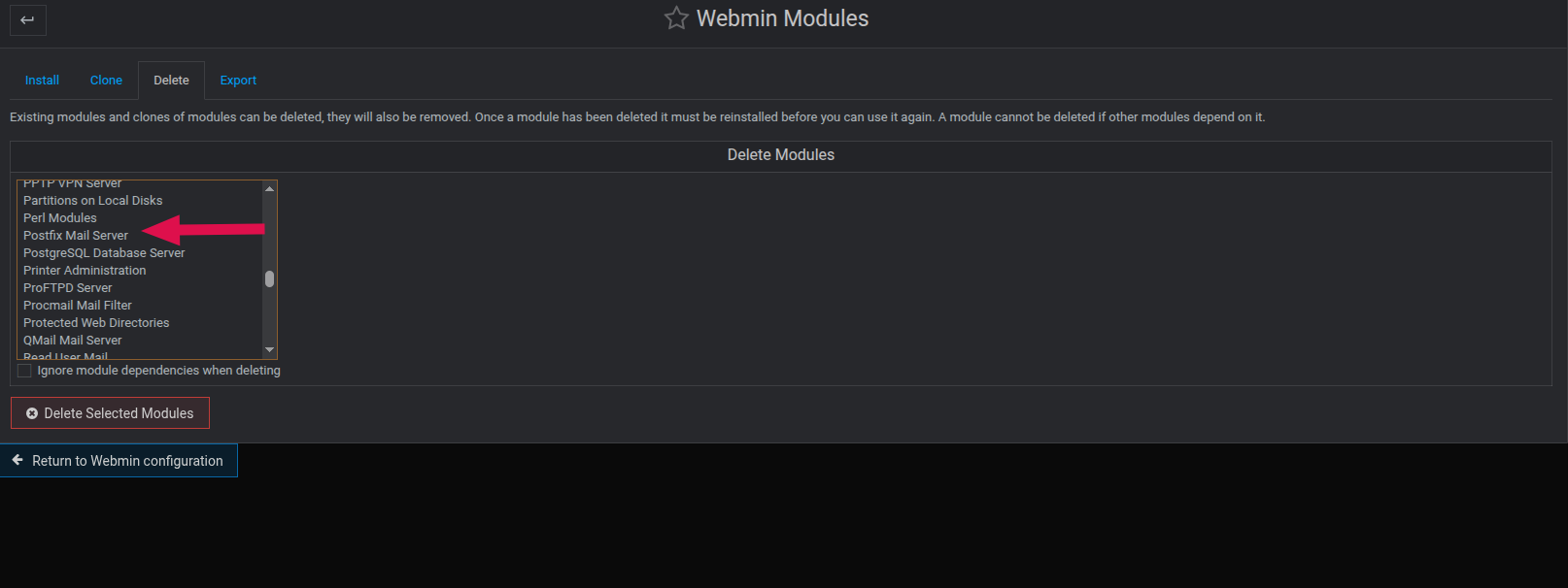

I don’t see any means of deleting a module and it doesn’t seem the OP did that.
Sounds like an @Jamie question?
you can do it here
@DJHK if you used this screen to remove the module just re add it via the install module tab
They need the module first.
Your screenshot eventually led me here:
I think that is why there is a “clone” option and a Warning on the delete screen. still think the --purge was the mistake

first I want to thank every single one of you for your quick replies. I have actually deleted it the way @jimr1 showed in his screenshot. I’d have hoped that sends it to unused modules. Didn’t.

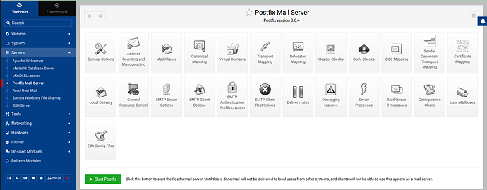

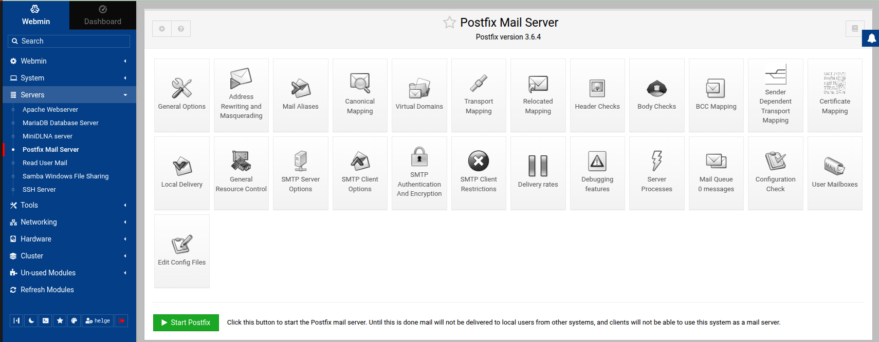

I have now subsequently with your help installed it again with @ID10T 's link. Thanks for that.
It’s now in servers.
I stopped it, so it’s fine for me now, and I can live with that.
But it would be perfect if I could somehow ‘uninstall’ it back to unused modules.

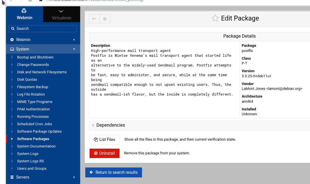

You uninstall Postfix with the package manager as shown, NOT the Webmin module.
Or end up in unused modules which is what normally happens when you delete a package
