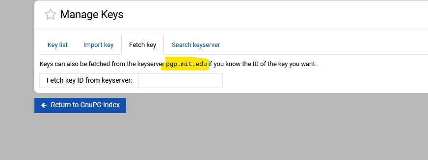

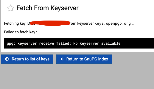

users cannot enc emails, the key server is not responding, but from the server console all is ok but not from usermin modul, i have also try to change the key server domain in the modul config, but dit not help
when i try
#gpg --keyserver https://keys.openpgp.org --search-keys (keyid)
then he founds the key

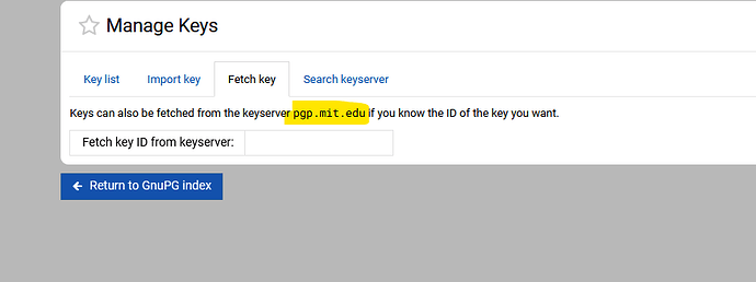

I don’t use this but just check usermin it uses a different server
and a search on that server, it seems to be decommissioned.
would this be the bug?
i have changed to openpgp
Looks hard coded, how did you do that?
usermin - module config - gpg
Still seems like a bug if you need to use cli, would a client know how to do that.

Use hkps://keys.openpgp.org instead in the “Keyserver to send and receive keys from” field in “Configurable options for GnuPG Encryption” page.
The “No keyserver available” error happens when GPG doesn’t recognize the keyserver URL format, and without a protocol prefix like hkps://, newer GPG versions don’t know how to connect.
Lastly, the test command you try should use the --recv-key flag instead of --search-keys:
gpg --keyserver hkps://keys.openpgp.org --recv-key KEY_ID

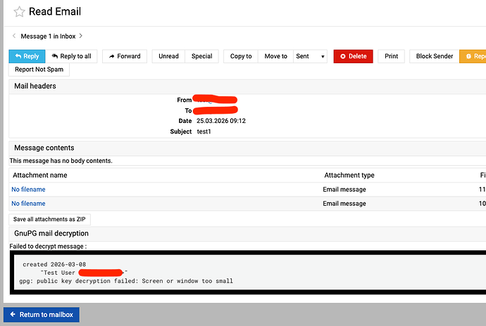

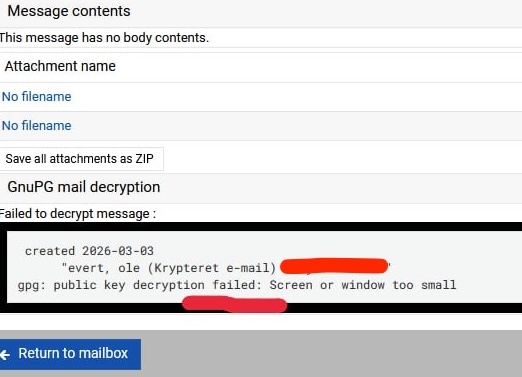

gpg: public key decryption failed: Screen or window too small
i have send a enc mail to my own email
so i have created a new key using the pgp in usermin, uploaded them to the keyserver.ubuntu.com and send a test mail to myself, then i have the gpg: public key decryption failed: Screen or window too small
Why did you suddenly use the hkps://keyserver.ubuntu.com server instead of the one we discussed earlier? Did hkps://keys.openpgp.org work for you?
And what does “not working” actually mean?
What about the following command output—does it work for you?
gpg --keyserver hkps://keyserver.ubuntu.com --recv-keys 1719003ACE3E5A41E2DE70DFD97A3AE911F63C51
ok this was my fault with the openpgp.com but openpgp.org was correct

now i have startet over again new email and new keys both publickeys uploadet to keyserver, send test emails and on the server wehn i try to open a email i have
but the keys are importet to the user, i can encrypt and send emails with this user but not decrypt emails
Why exactly doesn’t the description work for you? Do you see any error messages?
there is the one message:
and the email is not decryptet, i cannot read the messages in the email body

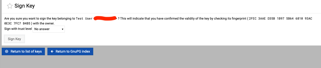

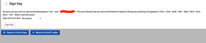

there is also a error when i will sign the email and encrypt
when i will sign a key, itakes very long time, never ends
To fix the warning about the screen or window being too small, run this command:
sudo sed -i.bak '/^sub decrypt_data$/,/pty_process_exec/ s|\$gpgpath \$pflag --output |\$gpgpath --pinentry-mode loopback \$pflag --output |' /usr/share/usermin/gnupg/gnupg-lib.pl
sudo systemctl restart usermin
Please let me know if it solves the issue for you.
