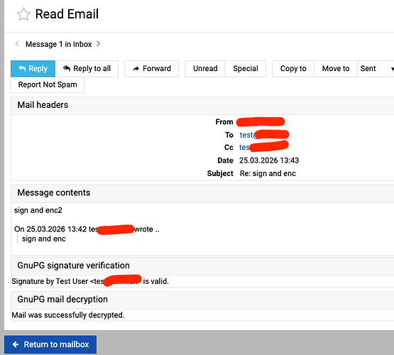

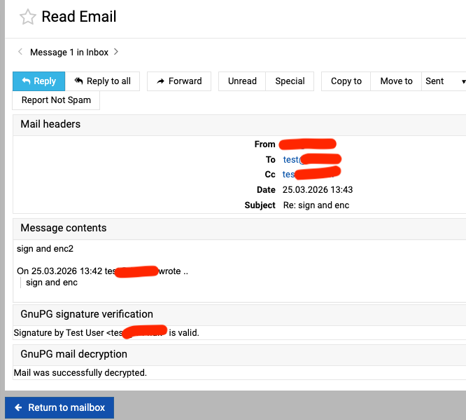

Gpg encryption in usermin
it works, i can now send adn encrypt messages also sign messages, i will try this with a other email to

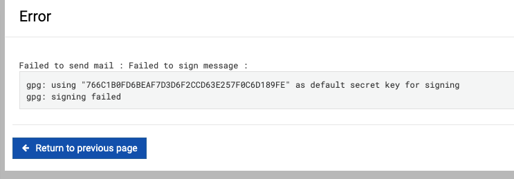

but the signing of a new key takes still long time, i have to stop the process, the wired is i have stoppet the process after 1hour loading screen in usermin mail, and the signing works
edit: signing still not works, i have stopped the loading screen, but send a email and sign them is not working
Try this patch as well:
sudo sed -i.bak '/^sub sign_data$/,/^sub verify_data$/ s|--batch --passphrase-file |--batch --pinentry-mode loopback --passphrase-file |' /usr/share/usermin/gnupg/gnupg-lib.pl
not working on page domain:20000/gnupg/signkey.cgi, i have also restartet usermin, still the same, the loading never stops and the key is not signed
