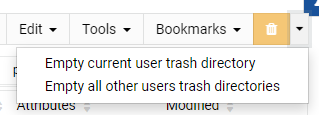

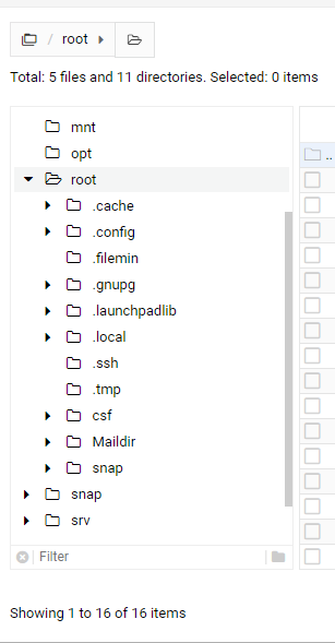

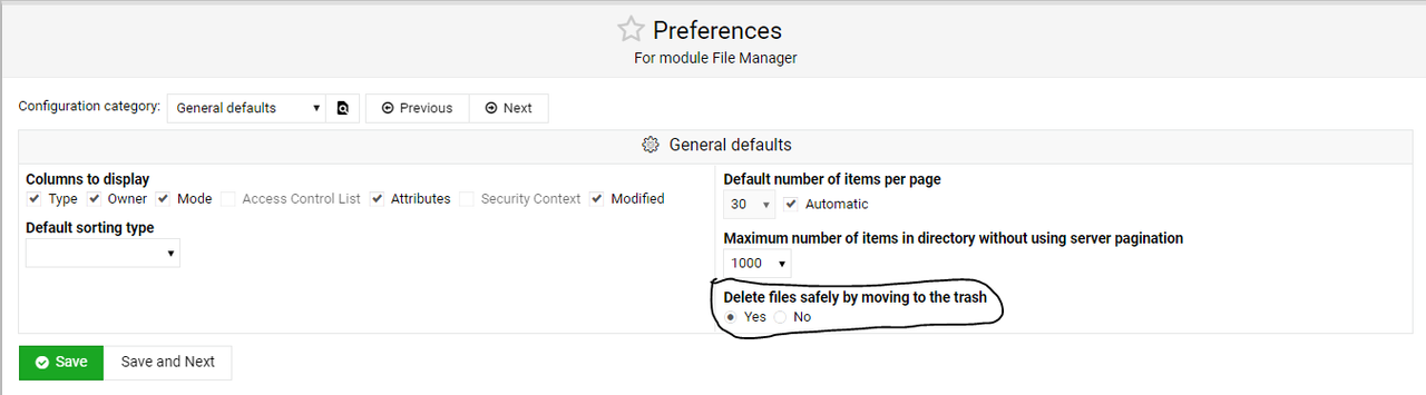

This is a feature of the file manager module. If you enable it deleted files are moved to ~/.Trash
however the OP may not have switched on the option to show hidden files (. files) hence he cannot see it. What is disappointing is there does not appear to be any way to restore the file right clicking the file in trash shows this
no obvious method of restoring the file, I thought that was the idea of trash ??
Can you tell me what I have to do to see the hidden files?
