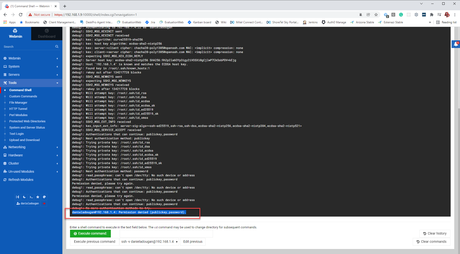

On that machine where you’re running Webmin, can you SSH to this server and try to login to your NAS using command:
ssh -v danieladougan@192.168.1.4
If that works keep checking further – try to switch to run your backup in a foreground using System ⇾ Filesystem Backup ⇾ Configuration: Configurable options page to see what’s happening upon the backup.
Thanks. I went to Tools > Command Shell and entered the command you supplied.
I got this in response:
danieladougan@192.168.1.4: Permission denied (publickey,password).
It never gave me an opportunity to enter a password though. Am I doing this in the wrong place?
@mediagiant,
This means that SSH is configured to “not allow” password authentication, hence it’s looking only for a valid public/private key pair.
You would place the “private key” in a file typically called “id_rsa” (which is the default name when you generate one using “ssh-keygen”) within the folder “/home/username/.ssh”.
The “public key” would then be pasted in a file called “authorized_keys” on the remote server inside the folder “/home/username/.ssh”.
