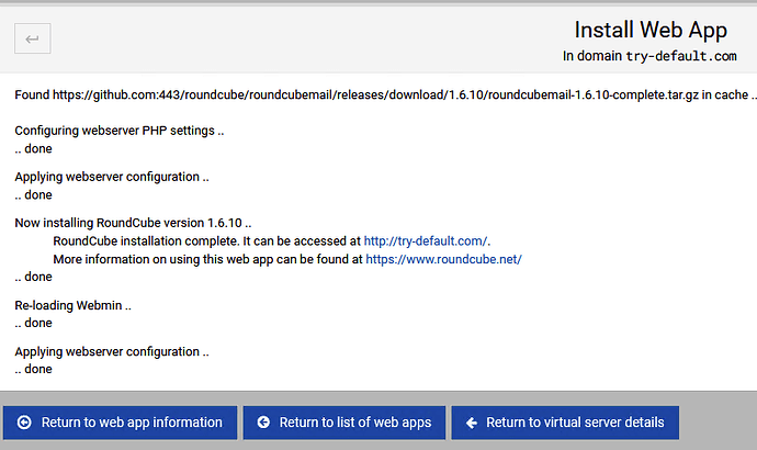

If I create a virtual server, with the defaults, and then click “Manage Web Apps” and select and install Roundcube, it works fine.

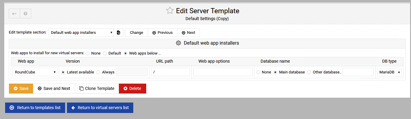

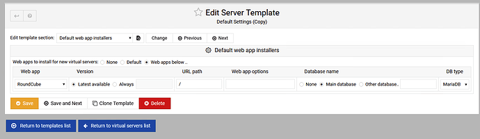

If I “Create a template from default settings” and only change “Default web app installers” thusly:

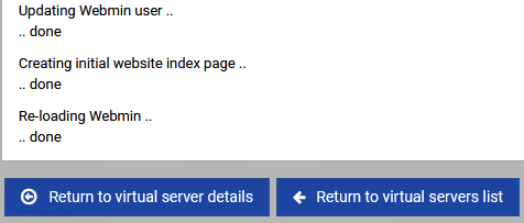

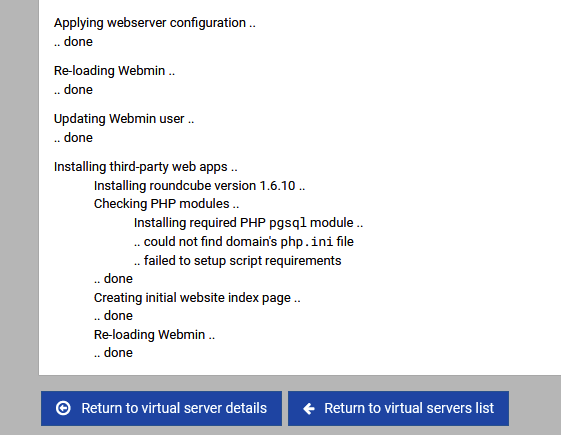

(with an aim to automatically install Roundcube) and I then create a virtual server (selecting “Default Settings (Copy)”) it ends this way:
Why?

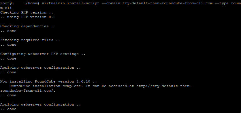

Adding to it, this:
virtualmin install-script --domain try-default-then-roundcube-from-cli.com --type roundcube --version 1.6.10 --path / --db mysql try_default_then_roundcube_from_cli
also works fine (though it took some doing to figure out which parameters are required and which are optional… and also the --db cannot be MariaDB or mariadb which might could be shimmed in there, it still did the right thing).

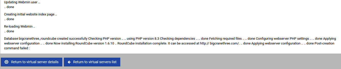

So far (detailed in this thread: Command to run after making changes to a server) I have this working reasonably for the same thing (in case anyone else needs it some time):
[ "$VIRTUALSERVER_ACTION" = "CREATE_DOMAIN" ] && virtualmin create-database --domain "$VIRTUALSERVER_DOM" --name "${VIRTUALSERVER_DB}_roundcube" --type mysql && virtualmin install-script --domain "$VIRTUALSERVER_DOM" --type roundcube --version 1.6.10 --path / --db mysql "${VIRTUALSERVER_DB}_roundcube"
When entered into:
System Settings -> Virtualmin Configuration -> Actions upon server and user creation -> Command to run after making changes to a server
It ends in an error/non-error… it knows that it didn’t error, because it says nothing about running anything at all if you leave “Only on failure” checked on “Always show output from pre and post commands” just below the command:
but if you check “Yes” there instead:
It says it failed somehow, but the database is created and Roundcube stuff is in it, etc. (It looks similar running from the command line, big blank below the “failed” line, detailed in the thread I linked above.)
