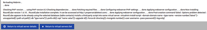

However it gives a message about the database (although the command seems to work anyway and the database is populated with roundcube stuff).
I get no such error if I remove that “after changes command” and make another virtual server and run what I believe to be the manually composed version of the same line from the command line:
virtualmin install-script --domain manualtest.com --type roundcube --version 1.6.10 --path / --db mysql manualtest
That just gives me:
So that’s kind of weird.
I does not display anything at all from a successful run though unless you (duh) check “Yes” on “Always show output from pre and post commands” here (which default to “Only on failure”):
So I suppose I can suppress the output to avoid seeing the confusing message (but it’s still happening for some reason).
Of course there are errors if I remove or change a virtual server with that line as my “after making changes”:
So a better fix in my case is to use something like:
[ $VIRTUALSERVER_ACTION = CREATE_DOMAIN ] && virtualmin install-script --domain $VIRTUALSERVER_DOM --type roundcube --version 1.6.10 --path / --db mysql $VIRTUALSERVER_DB_MYSQL
Which I thought might push the error out of the web buffer:
But it actually just doesn’t record an error that way if I run this from the command line, though it seems to think that it failed:
So maybe that “after changes” script expects a “success” message of some kind?
If “Only on failure” is checked, the web interface doesn’t count that as enough of an error to complain though so this is actually workable for me for now.
