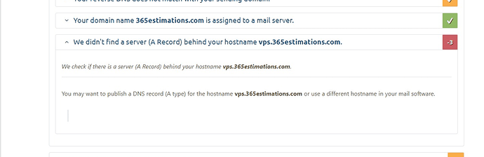

after that i am able to set my host vps.domainname.c0m
Now the problem is when i am trying to access vps.domainname.c0m:10000 i am getting DNS_PROBE_FINISHED_NXDOMAIN error. i set up all records for domainname.com how can i set records for vps.domainname.com in my namecheap account?

Respected sir this is somehow related to this topic as i am facing this after this virtualmin update. i was searching on google for ā€œFailed to create virtual server : The feature mail is not allowed for virtual server matching the hostnameā€ i am able to solve this by giving different host name but i am getting 4/10 rating on https://www.mail-tester.com/
You have made the correct move by changing the hostname. Please start a new topic. This topic is about something else.
