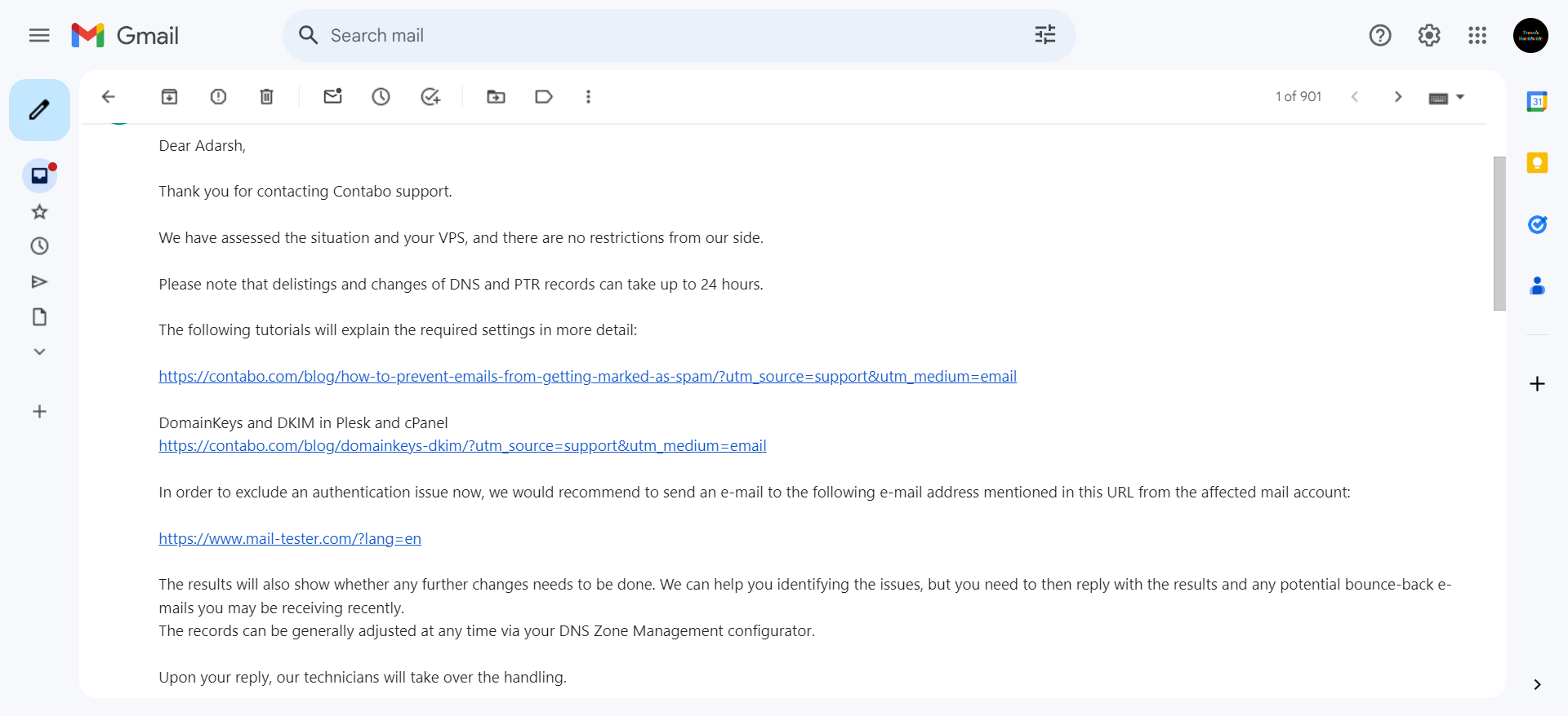

I have outgoing port 25 have a look on screenshort
And hosting provider also don’t do anything
