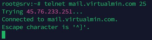

Here the result what I’m geting
So, you don’t have port 25 at all. It’s not just Google that’s blocking you.
That’s a question for your hosting provider or ISP. Many hosts/ISPs do not allow sending mail, some will unblock the port if requested. Some only block if they receive abuse reports about your IP. I can’t tell you why you’re blocked.
You can always use a mail relay service, as I suggested above, if you can’t get port 25 opened.

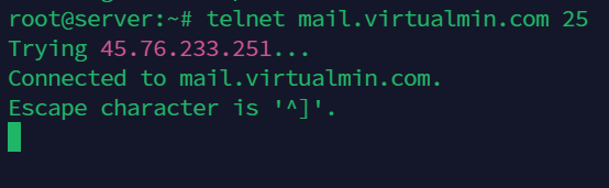

I tried testing one of my other server where i get same results but here everthing is working fine here sending emails is working, in both results i get connected to mail.virtualmin.com result
No more discussion here, Will check with hosting provider once, I just mailed the company.

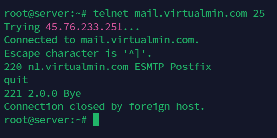

My problem is solve after restarting/rebooting the server, We can close discussion now :slightly_smiling_face:
