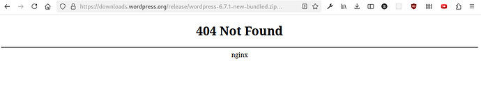

When I try to fetch that URL, I get this:
Which doesn’t seem like a useful thing. I don’t get a TLS certificate error, though. So, I see something that seems broken, but a completely different kind of brokenness than you see.
Maybe you want to try updating WordPress from the command line using wp-cli or in Virtualmin or even just manually downloading it? Even if it doesn’t work, it might give you a different shaped error and maybe we can suss out what’s going on.

I don’t think it shows the full ULR as it ends with an ellipsis (…)
Just checked and the WP version I have is 5.1.19. It’s an old blog which I installed manually many years ago and have simply moved it from server to server via the virtualmin backup/restore route. it did used to update itself automatically, so I wonder if it stopped when I moved to this server.

You’ll need to do it manually or maybe wp-cli can do it. That’s really old, so I would expect trouble. I guess that explains why it’s trying to use a bogus URL to download. Paths have probably changed.
