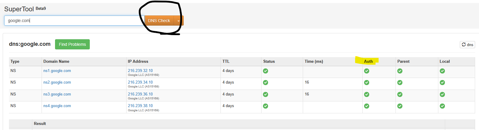

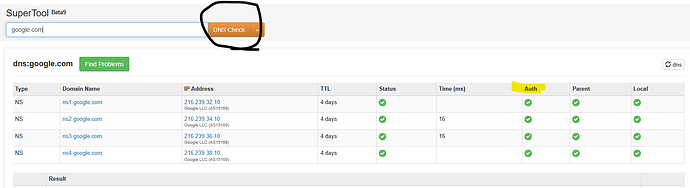

At mxtools, is everything green when you do a dns check

Everything could be green while still being misconfigured for OPs problem.
