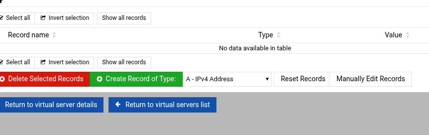

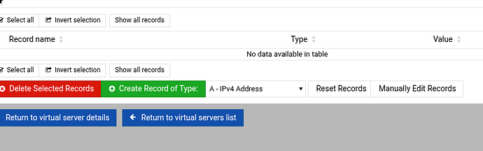

As for the A records, I’m not following.. I thought the A records were the ‘IN A’ above.. If not what option and where do I put them. I don’t see any option for anything besides what’s there. How should it look?

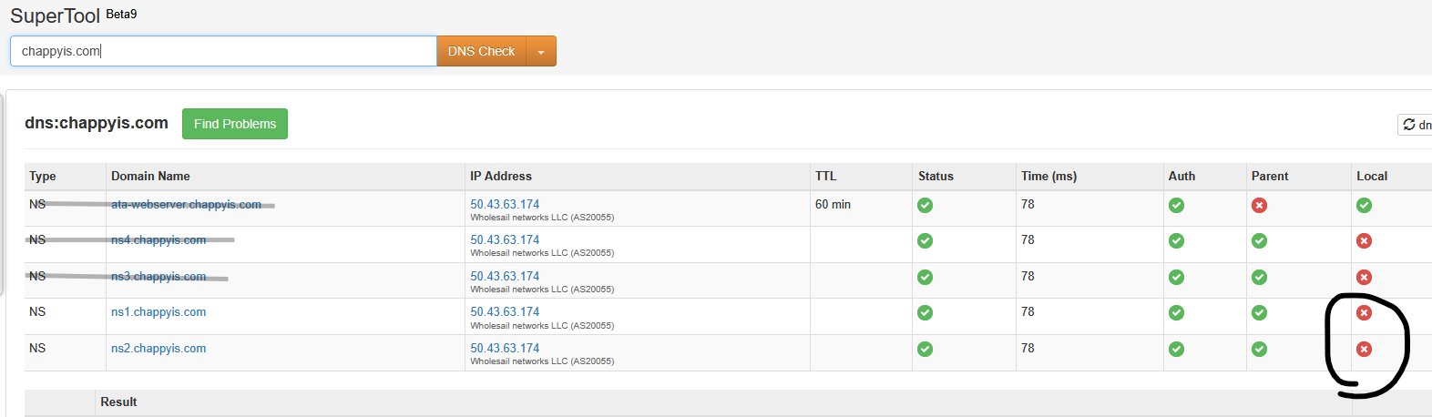

Why do you have so many NS record, you only need 2. MXtools can’t see a “Local” A record for your name servers.
I simple ping test proves there no A record.

If you want ns1 and ns2 to be your name servers for the zone (chappyis.com), you need:
chappyis.com. IN SOA ...
                NS ns1.chappyis.com.
                NS ns2.chappyis.com.
Edit: changed it to show the way it’ll look in the zone file on a Virtualmin system, generally speaking. The NS records for the zone usually appear near the top just below the SOA section.
And, you should have no NS records pointing to ata-webserver.chappyis.com. (I mean, you can name your name servers anything you want, but you said above you wanted ns1 and ns2, so do that.)
But, the point is: An NS record should point to the name of the name server. With this:
You’re saying, “there is a zone named ns2.chappyis.com. and the name server for that zone is ata-webserver.chappyis.com”.
