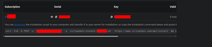

Why is that, doc say to use
sudo sh -c "$(curl -fsSL https://download.virtualmin.com/virtualmin-install)" -- --bundle LAMP
https://forum.virtualmin.com/t/custom-commands-module-has-gone/137403/67

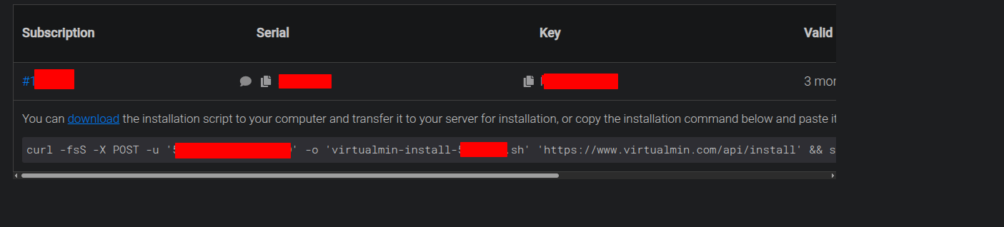

Right, pro. From memory I just add the licience into GPL and it worked, I can’t remember running a command
I had an existing licence so it seemed like the best option as you don’t have to upgrade from within the virtualmin, it starts life as a pro virtualmin install
