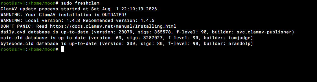

well clamAV instillation outdated is a normal warning and not going to stop databases from updating(unless it is a way outdated version and this is not)
I have to say I’m out of ideas as I never had such a problem with clamAV. I can only think maybe SELinux? was this just a standard download of RHEL 10.2? You will have to check all owner/group relations , I just dont know at this point.

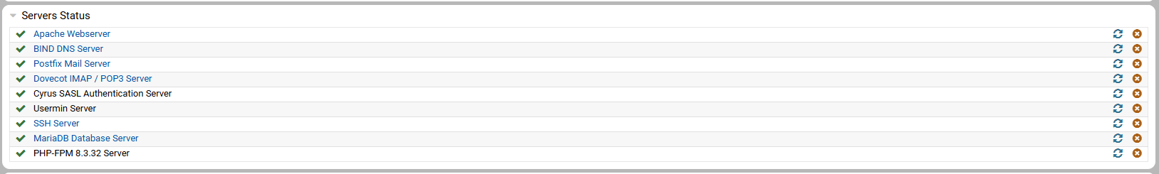

can’t see clamav in servers status.how to resolve this?
