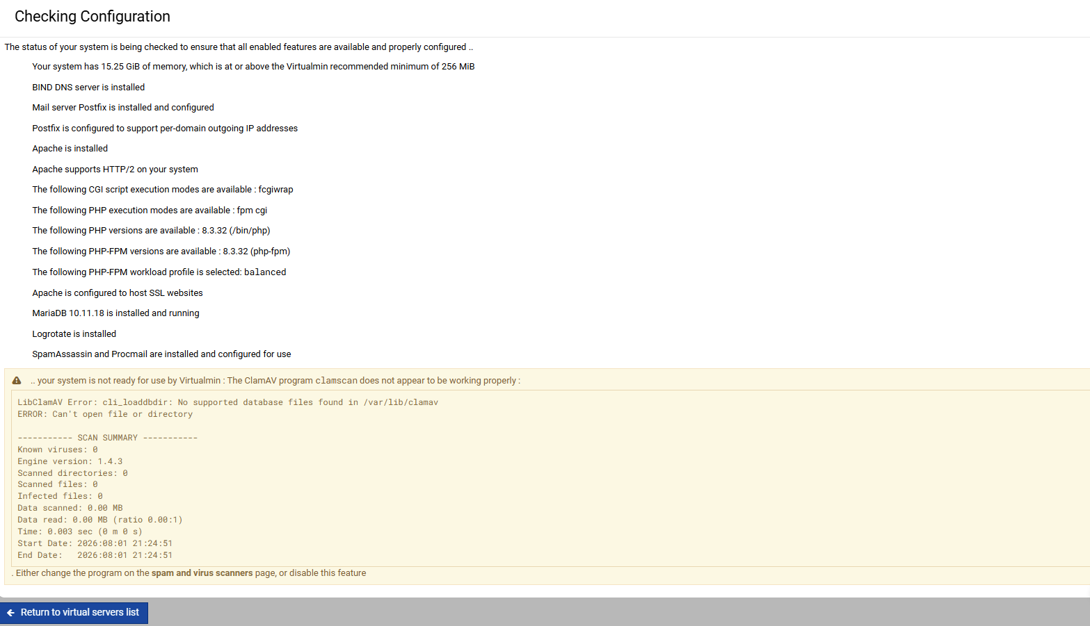

ClamAV won’t start

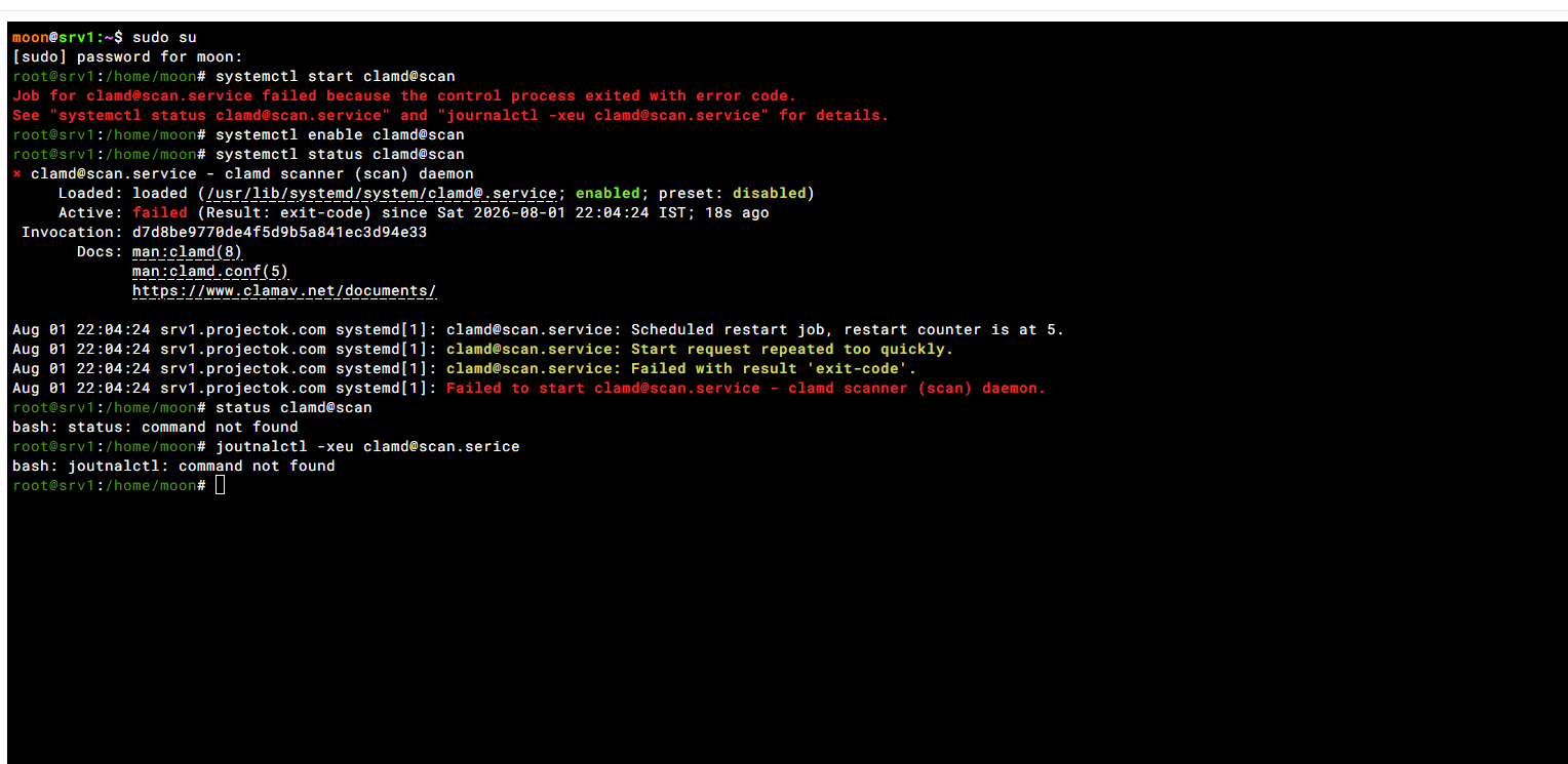

ok maybe try
systemctl start clamd@scan and systemctl enable clamd@scan
any errors? systemctl status clamd@scan

ok bare metal, rules out vps packaging.

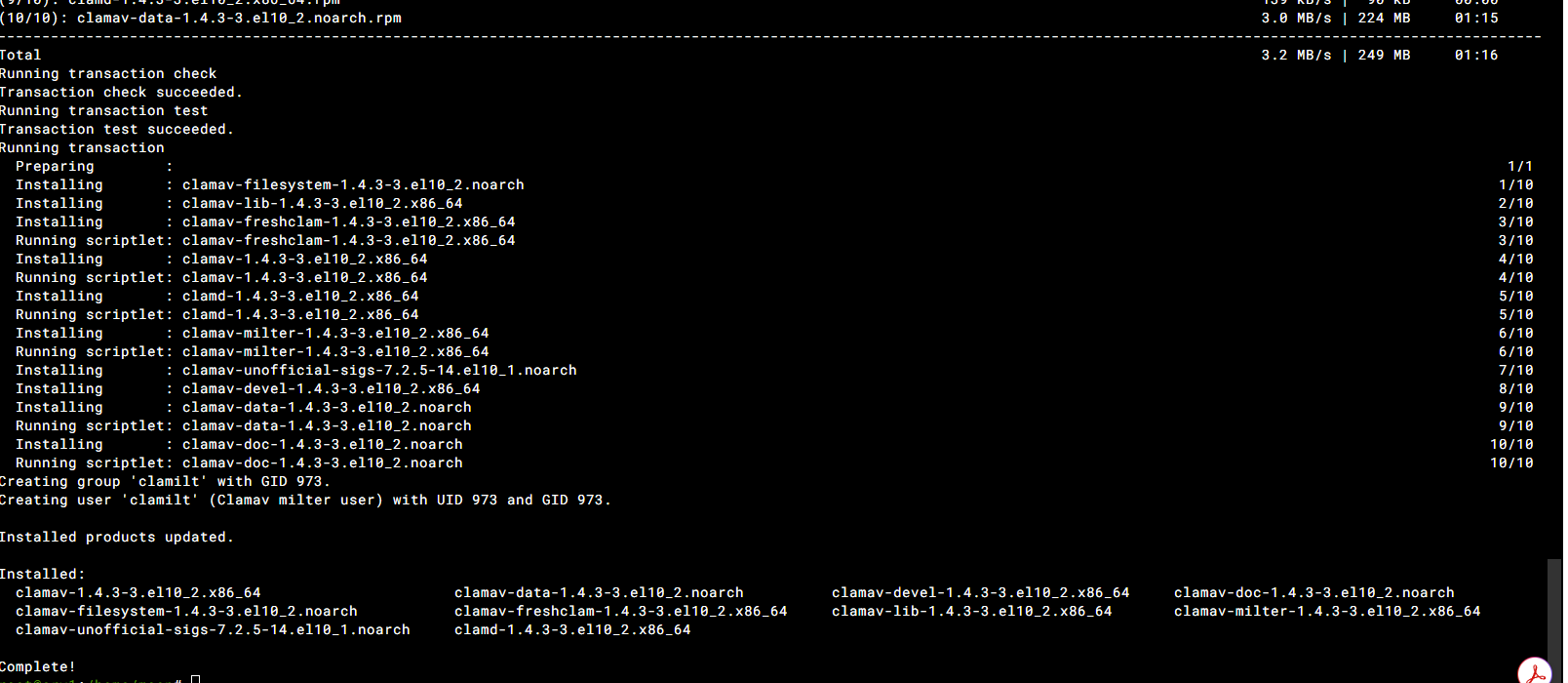

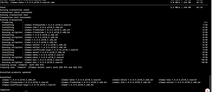

You can try (after removing) dnf install clamav*"
Trying to help but hard to say why, I mean can be SELinux, how you set permissions. Many variables here
Installed.

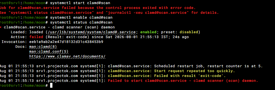

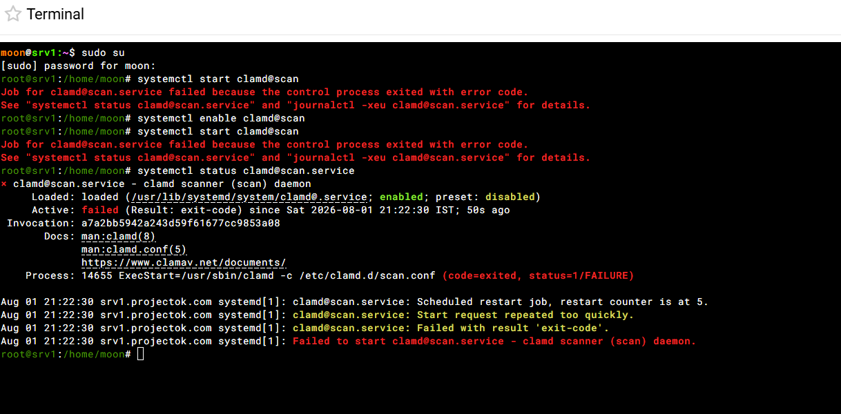

Tell me.I follow your instructions
or try status clamd@scan
what is the status?
ok what does joutnalctl -xeu clamd@scan.serice report?

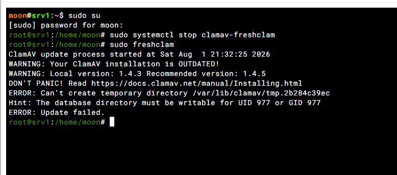

and you tried running freshclam?
