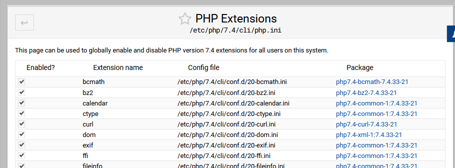

The main issue when installing a new PHP version like 8.4 over an older one is that the new version usually lacks some of the PHP modules that were installed for the old version, such as 7.4.
You can use the “Webmin / Tools ⇾ PHP Configuration” module and its extension management feature to make sure PHP 8.4 has the same set of extensions as previous 7.4 version.

Missing modules are:
imap
intl
json
zip
Which command will add them to 8.4 version?

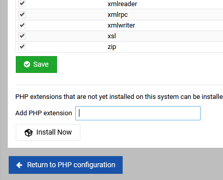

@Smedby You can click on the “Manage” button for the PHP 8.4 version in the “Actions” column, then click “PHP Extensions” icon, and add/install PHP extensions one by one at the bottom of the page.
@Jamie, We should accept a space-separated list of PHP extensions to install. Installing them one by one can be annoying.
The button
  • This is confusing. what exactly do you type in here. You need to know the full extensions name.
  • I will never use this. Unless you use the CLI a lot, you will never use this.
  • You would be better off putting a link to the package installer page with pre-done filters
  • When you have to guess the package names why would you not just use the package installer
The Page
This page serves no purpose for me. I will only install the extensions I need and remove them when I do not want or need them any more. If a developer needs to disable a PHP extension he will go into php.ini and comment out the line manually.
My thoughts
This page should be made to install and uninstall PHP extensions, not just enable disable.
The button at the bottom is not of any use. It is just another thing no-one really knows how to use or needs too. :frowning:
You can pull the extensions list repositories using a filter mask php8_ etc.. so an end user can select all of the php extensions in one go and then click install.
Maybe their is a list of PHP extensions that can be used instead of a parsing the repositories.
Maybe keep the enable and disable options for the users that will use it.

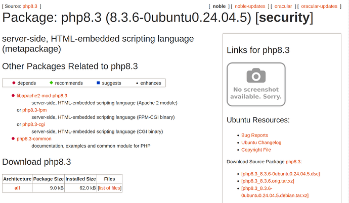

Do not follow that guide! It will install mod_php if you’re installing packages for the first time for a specific PHP version. mod_php is dangerous and breaks every other execution mode.
Specifically, you should not install the php8.4 package, and it depends on mod_php. This is very stupid on the part of the Debian/Ubuntu developers, and there’s been a ticket about it in their issue tracker for years, maybe a decade. But, that’s how it is.
I’m begging y’all: Do not tell people to install any phpX.YY package! Ever. Do not link to pages that tell people to install php or php8.4 or whatever.

I tried to show why you should not install the package named, e.g. php8.4 or php8.2 or whatever the heck. Don’t install that damned package, I’m begging you. It depends on mod_php, and mod_php has been deprecated for well over a decade. I literally do not know how to be more clear. Stop installing php or php8.2 or php8.4 or any phpX.Y package. That package does nothing but depend on PHP execution modes…but, the execution mode it depends on first is mod_php, and that should never be used. So, please stop doing it and stop telling people to do it and stop linking to websites that tell people to do it.
Our documentation tells you how to install PHP, there is no reason to link to third-party documentation that tells people how to break their system by installing mod_php.
