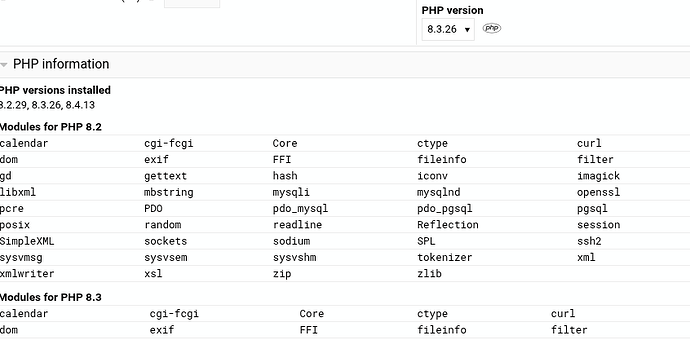

Back to the beginning. When changing the version would it be hard to implement code to show modules that are in the version used but not in the version switching to? Then maybe a link to where/how to add them? I’m assuming we aren’t letting domain owners just add modules at will here?

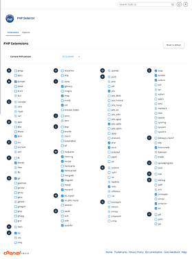

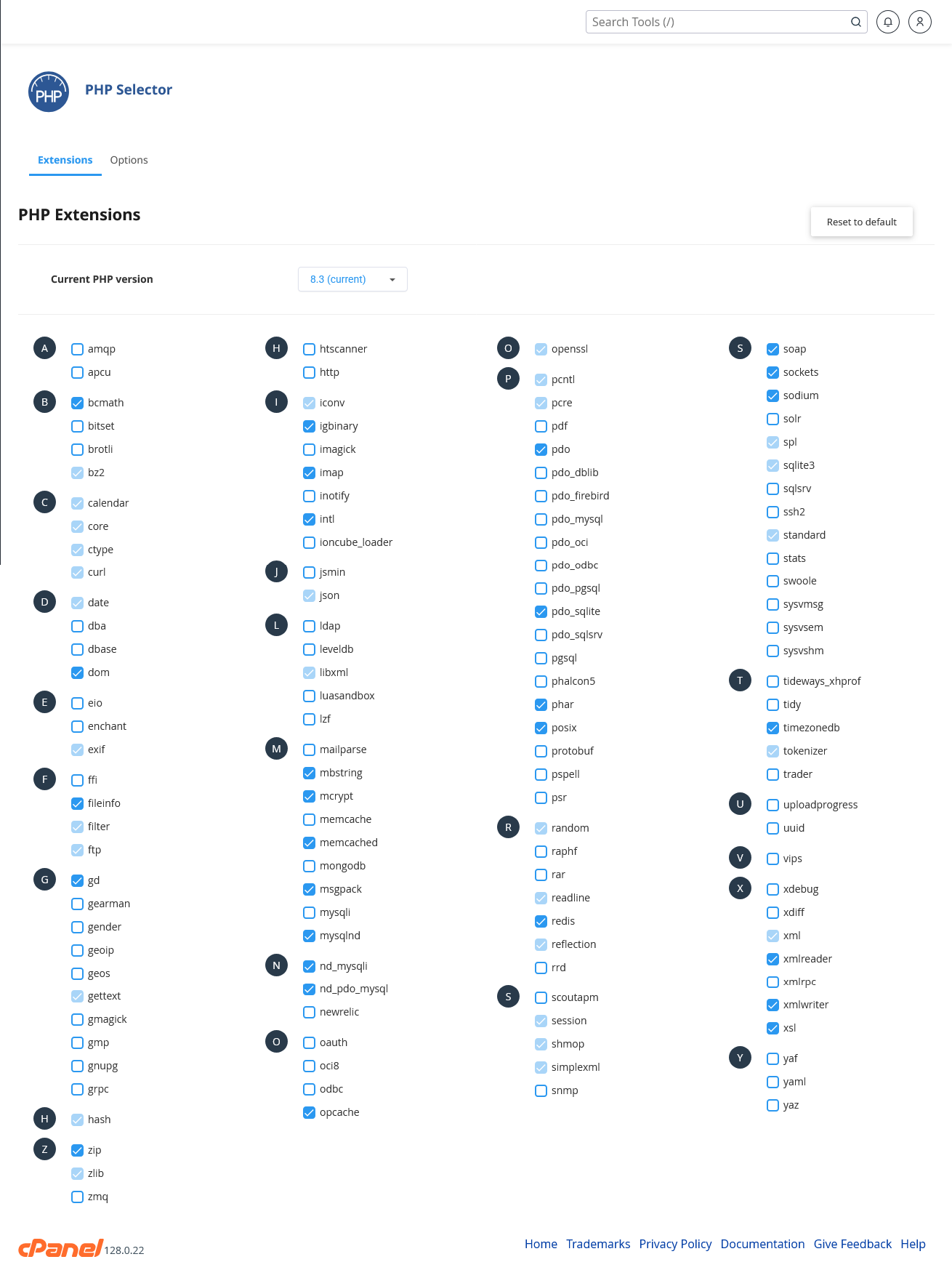

@Ilia is this available to a client account (i.e. not admin) in which case I can see the use for enable disable. perhaps a server template is needed here unless the server default is accepted until a change is made by the client.
This is from a cpanel user account running CageFS
See this discussion:
not really sure there is a discussion there. A couple of comments from February. have i got the right link?
Yes!
But the reason it’s not allowed is obvious—we don’t want a domain owner to disrupt other domain owners by disabling PHP extensions they think they don’t need.
2 small follow ups

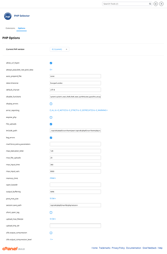

  • can the extensions not be disabled locally, with a local user.ini or php.ini
  • I am not an expert with jails, but maybe if you need a isolated system, then this feature could be added it.
No, because from what I understand, PHP-FPM pools share the same PHP binary and its compiled extensions, so all modules are loaded globally, and once loaded, they’re active for every pool.
it it possible (cPanel CageFS) , but I appreciate it maybe not on a virtualmin setup.
I can PM you the credentials if you want to have a look at my test site.
I don’t really like the idea of shared hosting; I think one virtual machine per domain or user is the right or at least a way better approach.
The whole nature of virtualmin is shared hosting.
