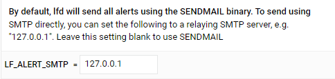

cfs does not send me emails. I have activated all its notifications but nothing. The mail server is postfix and I have set the ip to 127.0.0.1. I try to put the wrong port in ssh and it blocks me normally. Help please, what should I do to fix it?

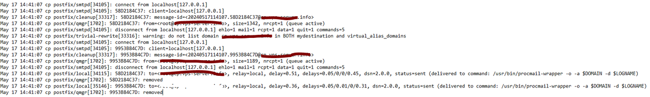

Email log for time 14.41

postfix/trivial-rewrite[33316]: warning: do not list domain_my_hostname.info in BOTH mydestination and virtual_alias_domains
That a warning not a error, it shouldn’t cause a issue, it can be fixed as I have seen it before.

Look at csf.conf and check for LF_ALERT_ options set in it. Try this command to fetch what’s configured:
grep 'LF_ALERT_' csf.conf
To send alerts to root, you might want to remove all mentions of LF_ALERT_*.
# Leave this option empty to use the To: field setting in each alert template
LF_ALERT_TO = ""

LF_ALERT_TO = “admin@mysite.com”
I put this but it doesn’t send. It only sends to root and I can’t figure out why…
