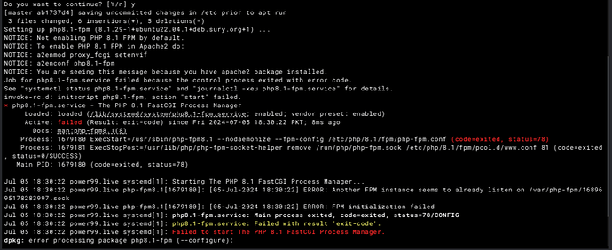

i have just made a radio live stream player and inserted it in the code of my website, the the stream URL protocol is HTTP, live stream player plays the stream on all mobile devices very well and on desktop only Firefox browser plays it, chrome and the opera are not playing the stream , when i made inspected the page and tried to find the error in the console i came to know that chrome is automatically converting the stream url’s HTTP request to https, that is why the stream on the desktop and laptop browsers is not playing, i then searched how to solve the issue and chatgpt told me to install the cerbot to forward the request of the HTTP also, and when i tried to install the cerbot php8.1 fpm failed to start
the response of the chatgpt about error (screenshot) is given below
It seems like there’s an issue with PHP 8.1 FPM because another FPM instance is already listening on the specified socket (/var/php-fpm/1689695178283997.sock). This conflict is causing the initialization of PHP FPM to fail.

Also what cammand are you running that you answered Y too, screenshot does not show.
i installed php 8.1 using the webmin terminal tool and the cammand’s screenshot is attached below

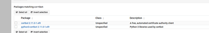

Yeah I would, my package manager shows cerbot already installed.
I presume its needed for LetsEncrypt

Looking at your screenshot it is installed, maybe this is just a php 8.1 issue.

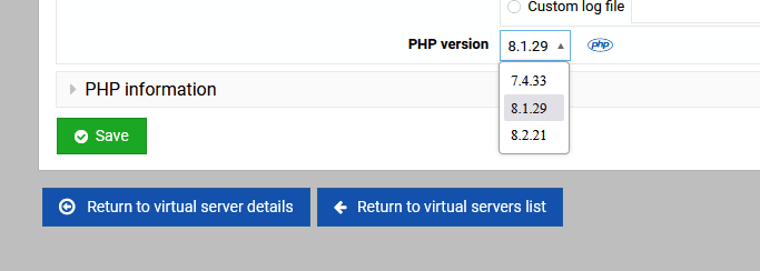

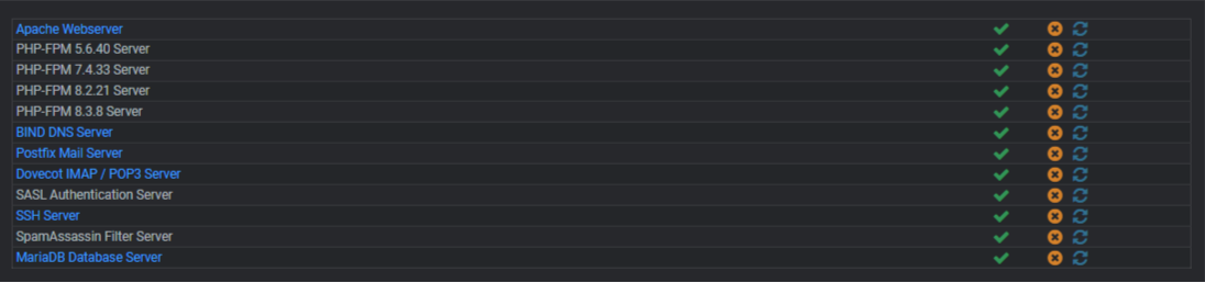

one more thing please i am uploading a screenshot that show the php versions running, i have 4 websites on hosted on this system please look at the screen scot and tell me if i uninstall the 8.1 will it affect any of my website
please confirm one more thing , i think that the website that have radio stream player installed must be using the 8.1 php, right?
Looks you have install using muliple-php method, do you have the dropdown in php options in the virtual server.
No idea, whats the name of the program, if its programed in php, it would need a php version thats compatible.
Maybe your trying to install php8.1 fpm service on top of a currently running php8.1 fpm service.
certbot is already installed (it’s installed when you install Virtualmin). It has nothing to do with your problem withphp-fpm.
