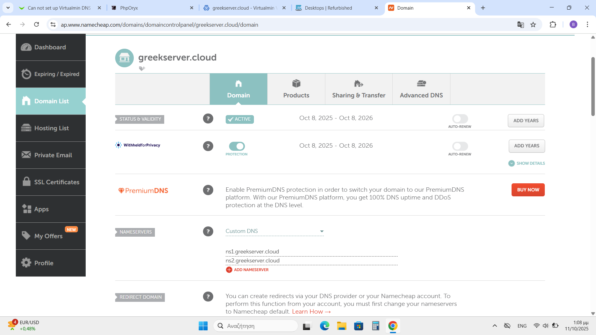

I have a domain greekserver.cloud with a glue record-custom name server ns1.greekserver.cloud pointing to the ip of the server.
The server hostname is ns1.greekserver.cloud with dns enabled. Why isn’t working? What am i missing?

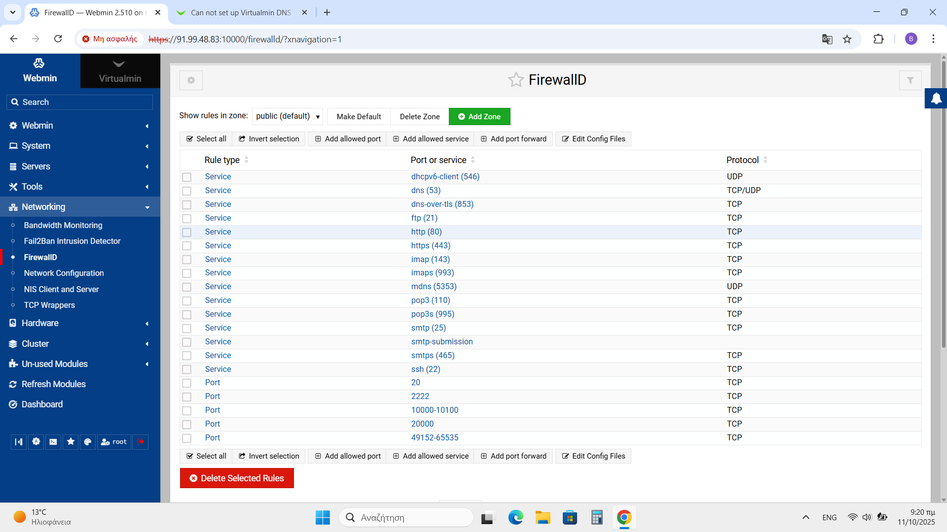

I have this rules in firewalld. How do i open port 53?
If this is a vps rather than a stand alone machine you may find that your VPS providers firewall does not have port 53 open, but many give you the ability to open the port via their vps control panel. From your screenshot firewalld has port 53 open

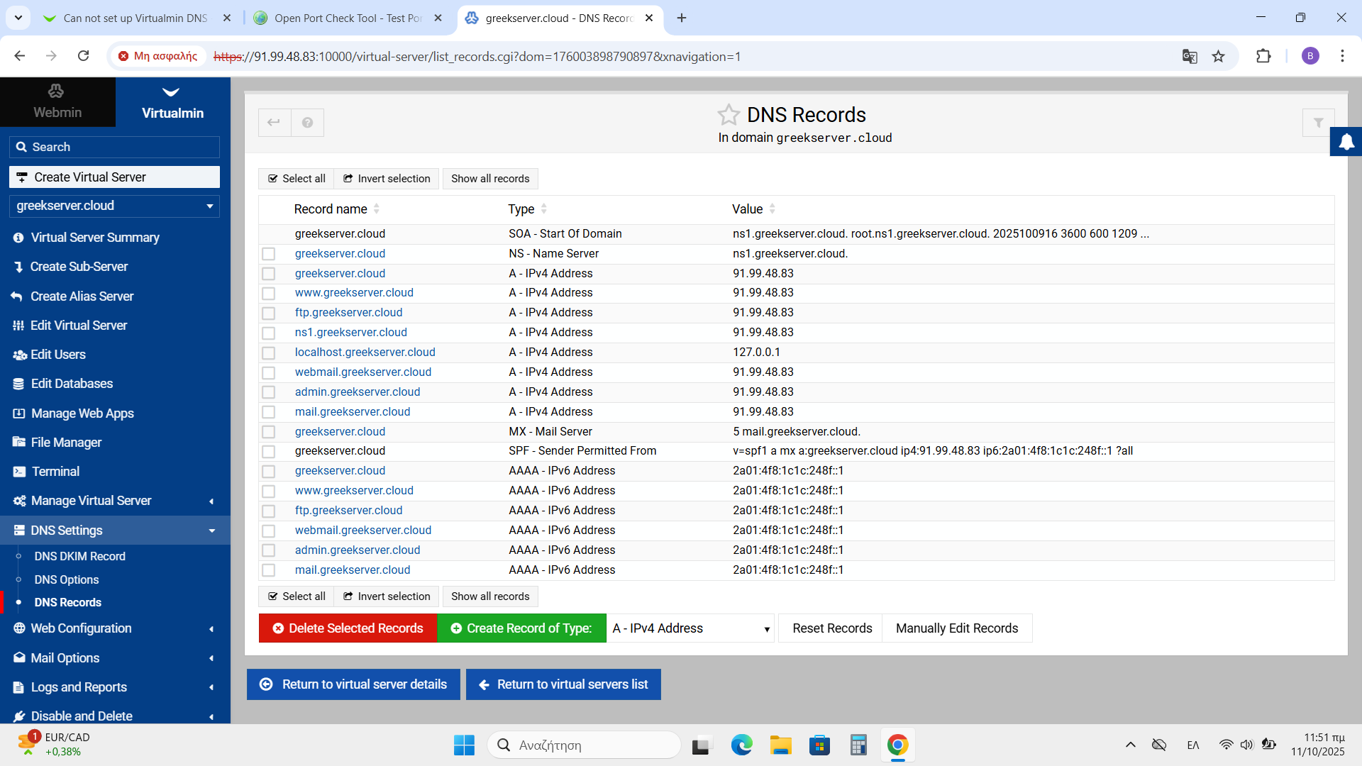

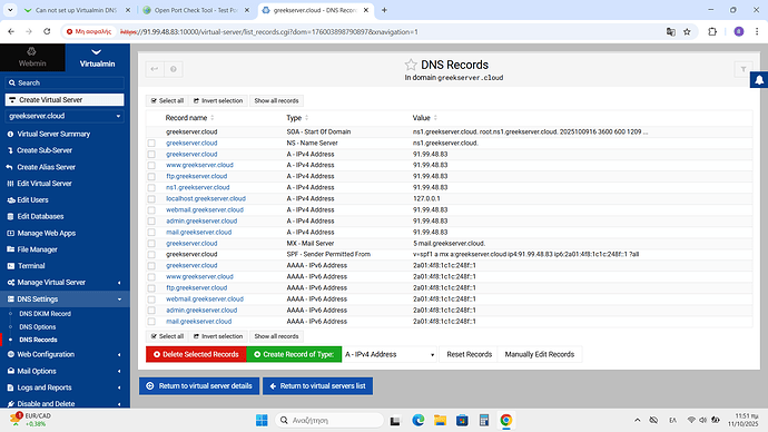

show us the DNS page for the virtual server so we can see the records.
when you create greekserver.cloud in virtualmin go the DNS page and make sure you have ns1.greekserver.cloud with an A record to your IP and that you have NS records with ns1.greekserver.cloud for the domain.

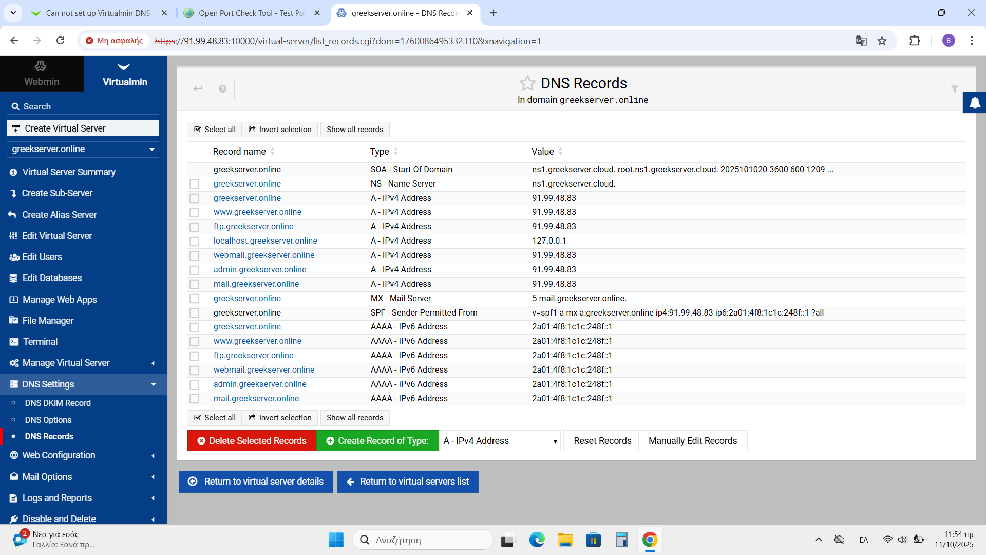

A also have a second domain greekserver.online with the attached dns settings. Doesn;t work either.

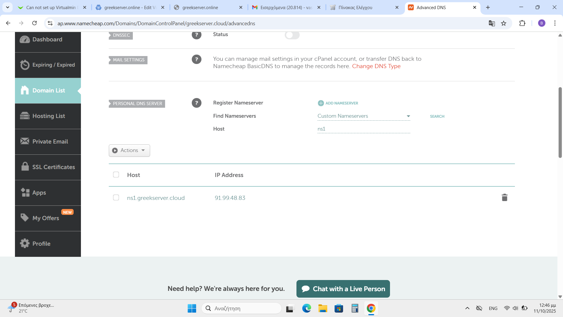

Check if the glue records are setup correctly at your registrar.
Bind is running. Nameserver name is correct in whois search. Port 53 is Open That is is the nameserver used on registral.

ok have you also set that nameserver for your domain? you need to do that also in the namecheap interface.
Yes i did.
