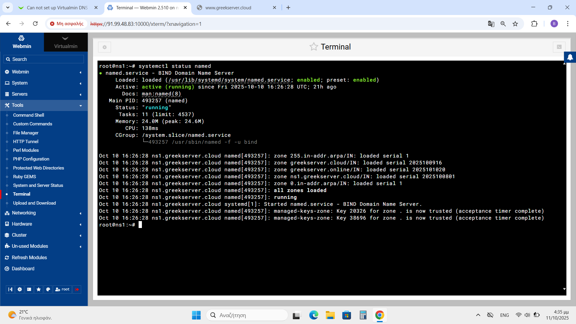

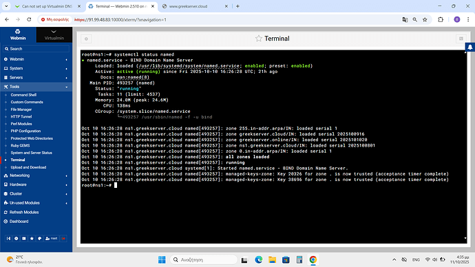

bind is not working for/resolving your domains. better check system logs and bind config. did you try restarting it?
I explained a previous post, maybe i didn’t explain in the easiest terms but the answer is there, I had this very problem a few years ago and the method was put into place and has worked ever since
It won’t until the OP gets his name servers resolving to the correct ip address
on rhel derivatives it would be
systemctl status named I think on debian derivatives it is systemctl status bind
there you can see the last messages and see possible errors.
also check the logs.
you can see logs within virtualmin also.

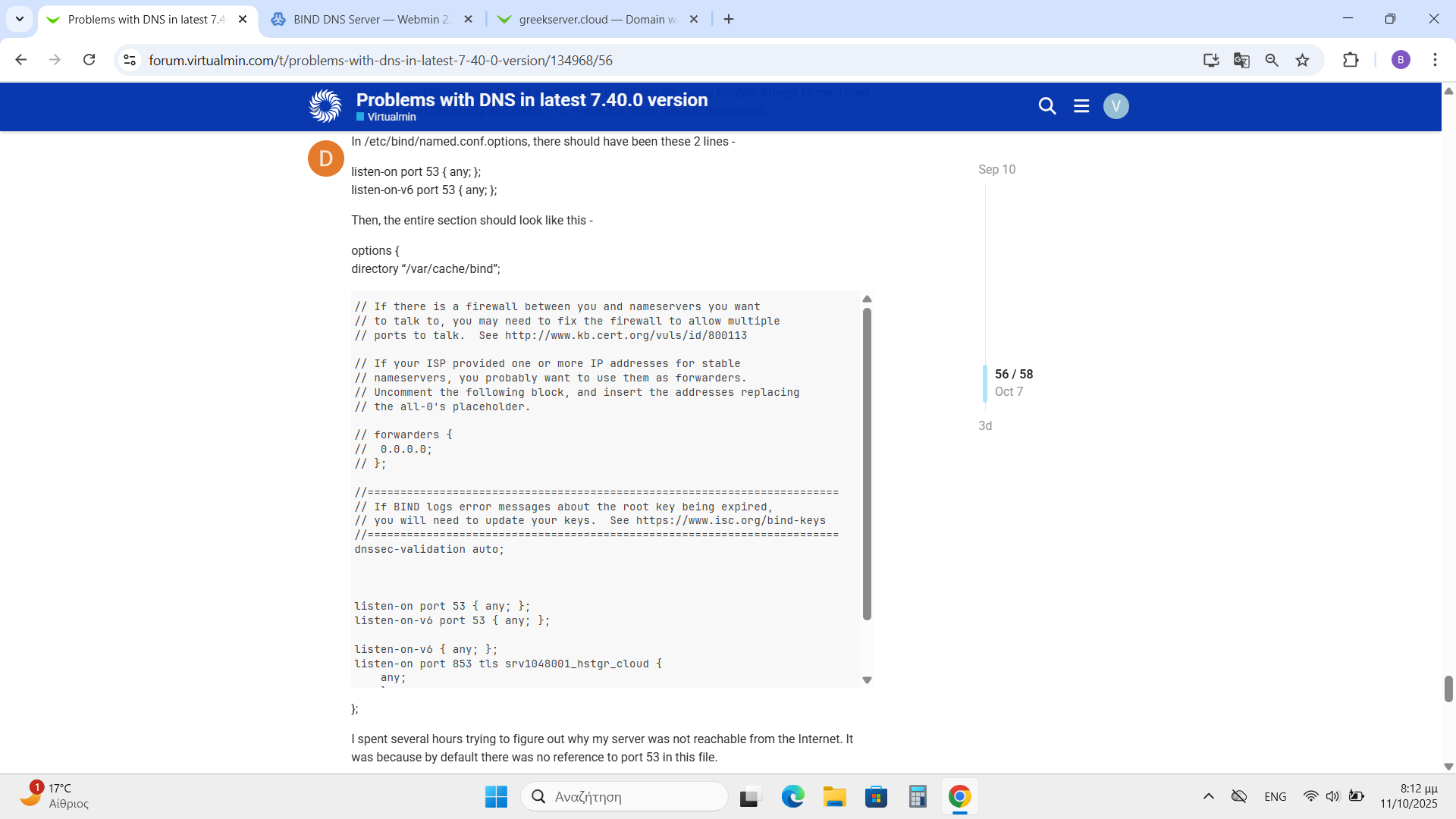

maybe you have this problem:
Problems with DNS in latest 7.40.0 version - Virtualmin - Virtualmin Community

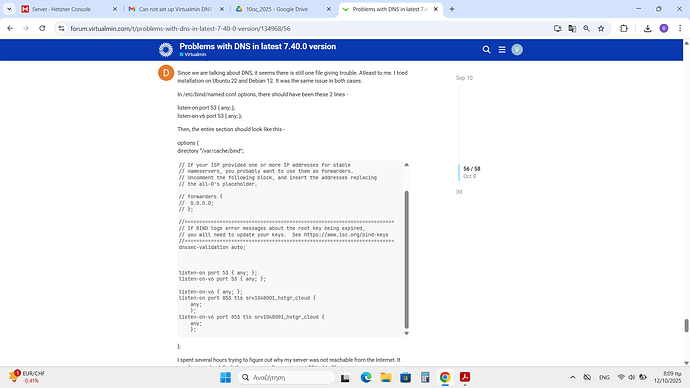

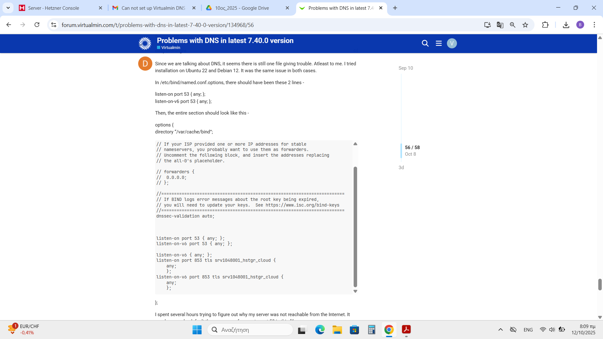

Thank you my friend. I was able to resolve the issue based on your suggestion. For anyone has the same problem with bind dns with the latest 7.40 version do that: thanks to @deepakdhingra

Tar
In /etc/bind/named.conf.options
Add these 2 lines:
listen-on port 53 { any; };
listen-on-v6 port 53 { any;
As shown in the screenshot above.
DNS for domain has to be enabled to see the listed lines in order to add the 2 extra lines.

The solution is from @deepakdhingra. I am new to forum, i don’t exactly how to do all that. I posted the screenshot because i thought that it could help sb.

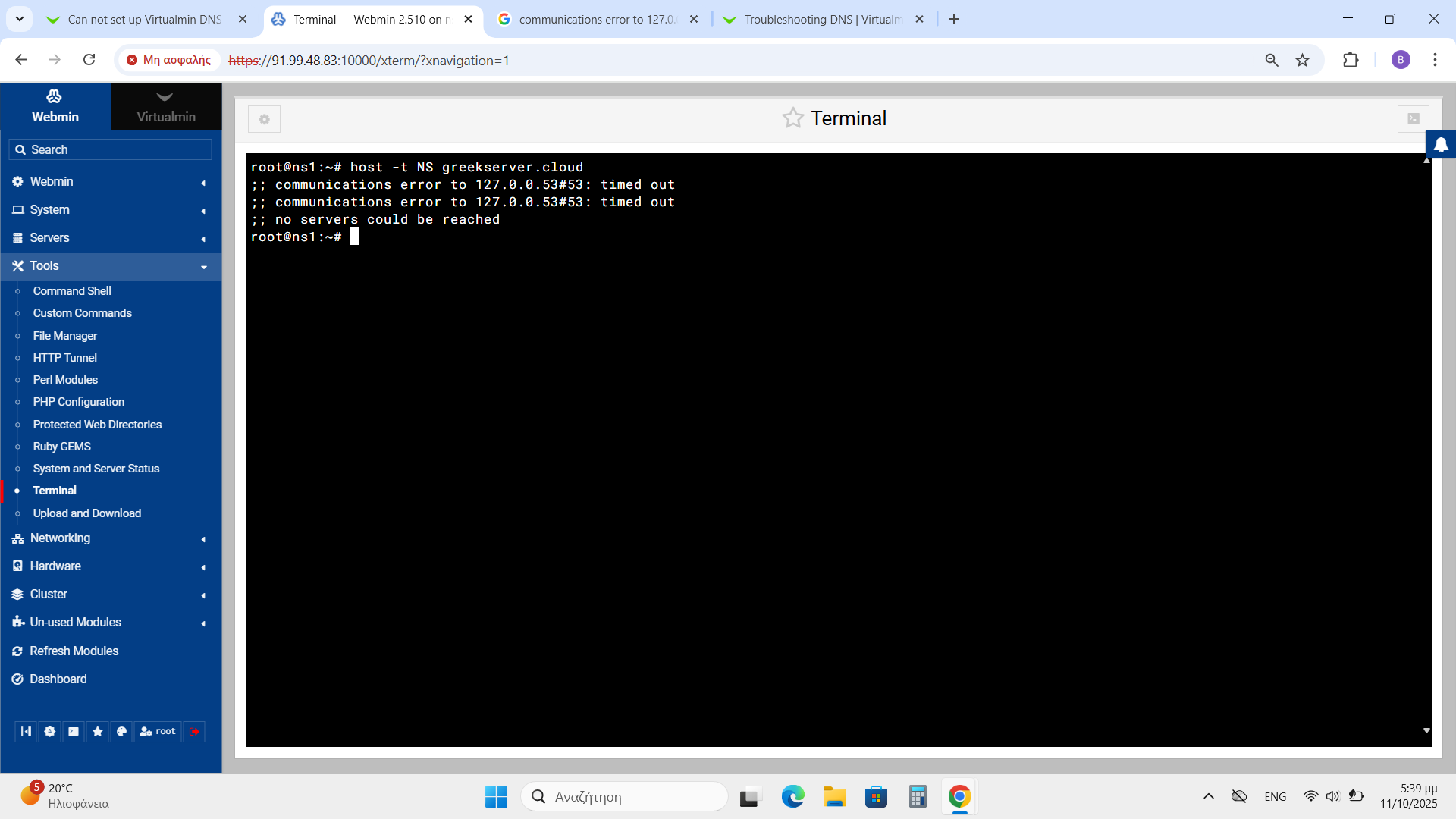

however in this case it has not solved the problem try
dig greekserver.cloud NS
you will get

from that you can see that the nameservers for that domain do not resolve so therefore is not accessable from the outside world
