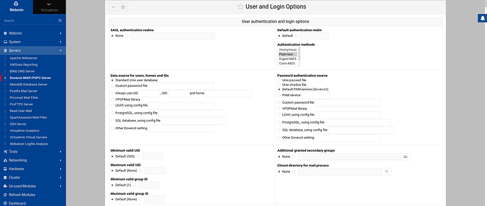

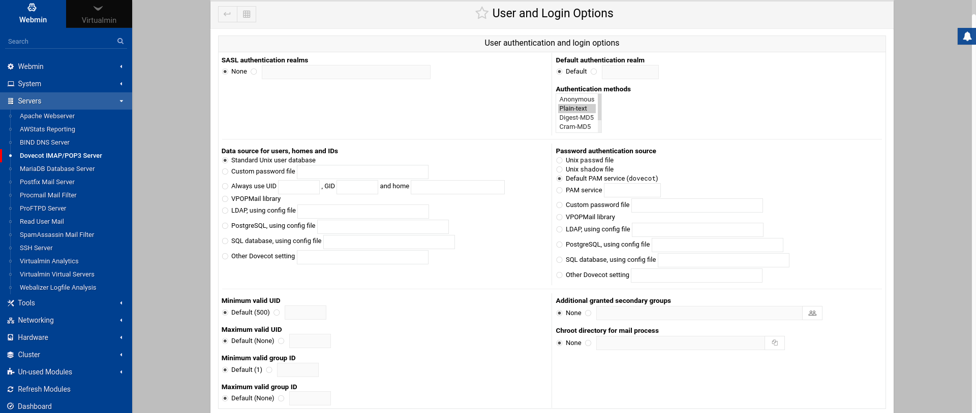

I fail to understand how a mail Configuration problem has anything to do with how with a retest of the vm config you need to fix the error. Where the error lies in the postfix Configuration or dovecot Configuration
Did you read the previous error ?
This are default Dovecot settings for autentification. User ID 0 is root, so is a legit account.
And this is Postfix default
After you change settings you need to restart Dovecot and Postfix, than test
thank you for your reply , but the problem didn’t solve .
my configuration was the same as yours
