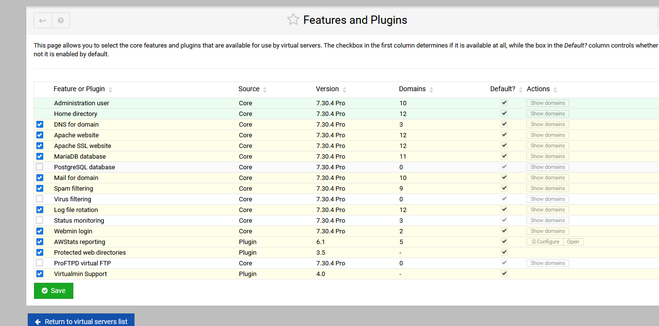

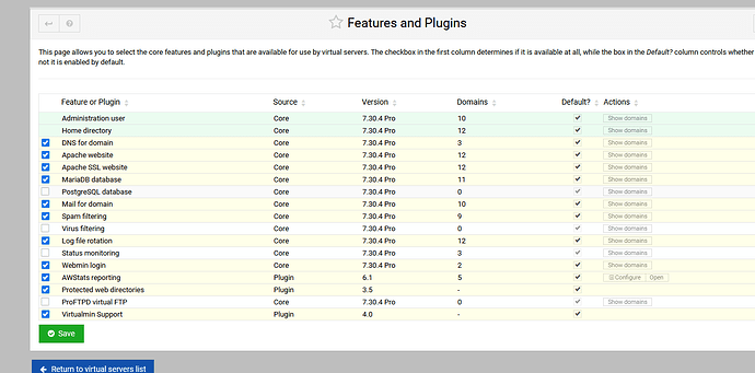

This is my select on default server:
And this is default server response:

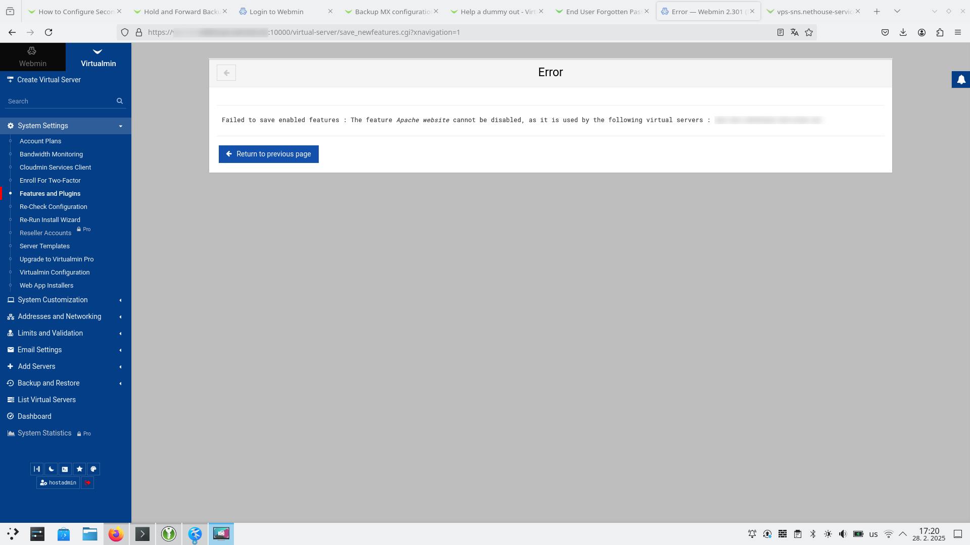

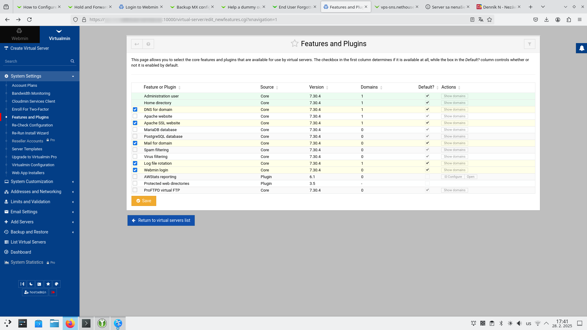

And I have problem with this. I don’t want web server enabled on bakup MX and slave DNS servers.

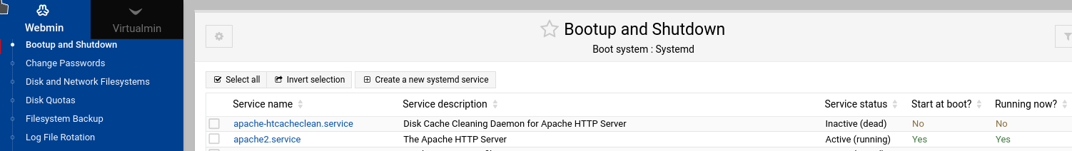

Even if it won’t let you remove it you should be able to stop it and keep it from restarting at boot up.

I think the new version of Virtualmin has creates a dummy “virtual server” so it can get a ssl for the hostname. In webmin is that virtual server in apache?
I’m note sure there away around it, if you disable it somehow then the letsencrpt cert can’t be renewed for the hostname as it need a website running.
Yes, I can disable apache service, but why? Why do I must install this, if I don’t need it?
