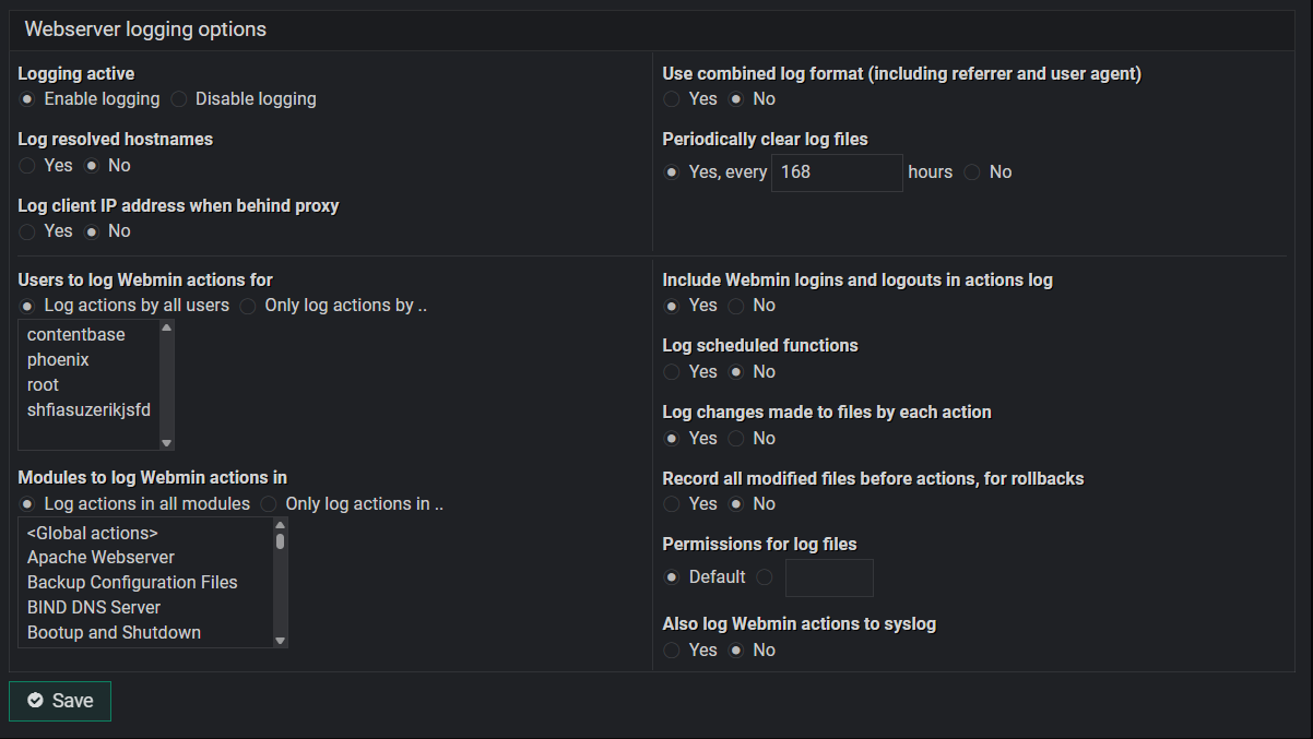

Have you checked the logs? I’m not sure where this would be though. My backup directory is set to discard after 3 months and it appears to be doing that. I believe webmin has its’ own logs.
Nothing relevant to the backup process, systemlog shows

What do you have set on the “Webmin ⇾ Webmin Configuration: Logging” page, and what about the “Record all modified files before actions, for rollbacks” option? Is it enabled or disabled? If it’s enabled, disable it and try again.
If you want to keep that option enabled, you need to apply the patch below to make it work as expected:
webmin patch https://github.com/virtualmin/virtualmin-gpl/commit/7c77117
It’s not enabled
