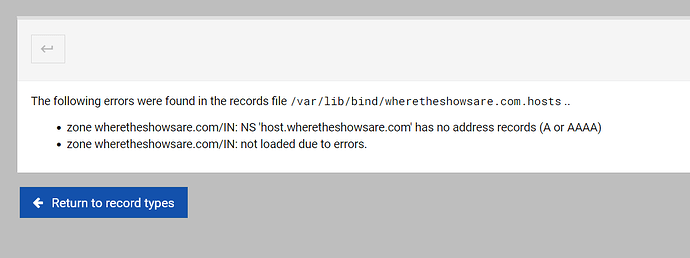

I’ve had to move a very large website from my old server to a new one. I ran the Virtualmin backup software and when I restored it on the new server I got this error
The following errors were found in the records file /var/lib/bind/wheretheshowsare.com.hosts ..
zone wheretheshowsare.com/IN: NS 'host.wheretheshowsare.com' has no address records (A or AAAA)
zone wheretheshowsare.com/IN: not loaded due to errors.
It is inheriting the settings from the old server but I’m not sure what to do to correct it on the new server. The nameserver refers to the old server (and is still active there since I have not moved that yet)
Virtualmin re-check will not work because of the BIND error. This happened on another website move too and I manually moved everything which took a long time. I’m sure there is a more effective solution!

You need to add address records or remove that NS record. If that is a name server you’ll be using for this zone, you need to add address records (A for IPv4 and/or AAAA for IPv6). If it is not, you need to remove the NS record.
I’m guessing you chose to include the system hostname (assuming host.wheretheshowsare.com is the system hostname Virtualmin is running on) as one of the name servers Virtualmin automatically uses when adding a virtual server. When you do that, we’re assuming your hostname resolves. You would have had to tell Virtualmin to skip checking for resolvability when you chose that during the setup wizard, since we try to protect against this problem, but we trust you’ll make it resolve eventually.
You don’t need to use the Virtualmin server as one of your name servers, but it’s a common choice in a small-scale deployment like the sort most people using Virtualmin are building. And, you don’t need to use the system hostname for that, but it’s a common choice, so that’s what we default to.
All of this is configurable, but if you’re including the system hostname as one of your DNS servers, it must resolve. If that name is in one of the zones managed locally, then you’ll need an A record for it in that zone, and it won’t be automatically generated by Virtualmin (unless you’re doing something complicated and have added it to Server Templates to do something custom).

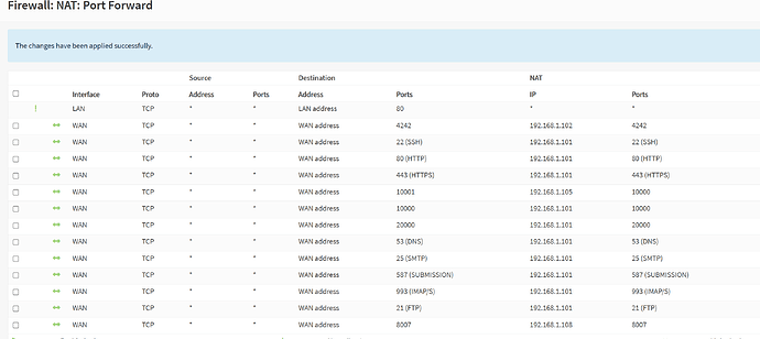

This server is actually behind a router. It’s local address is 192.168.1.101 I believe I have forwarded all the appropriate ports.
