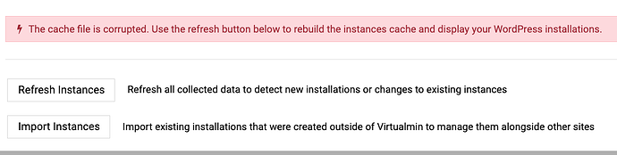

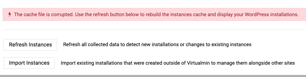

I just installed WP Workbench and receive the following error:
When I click refresh instance, the following loads, but the initial error does not go away.

If you manually delete the cache-* files under the /var/webmin/modules/virtualmin-wp-workbench directory, does the error go away?
Thanks for the response. There was a single file in that directory: cache-root.json
I deleted the file, and then clicked on Find Instances. WP workbench find the instances, but I still have the same error when I return to the dashboard. Thanks

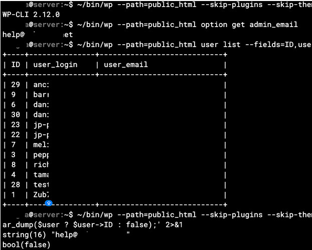

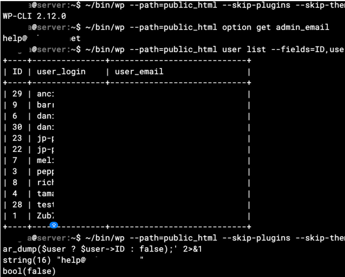

And what is the output of:
~/bin/wp --path=public_html option get admin_email
~/bin/wp --path=public_html user list --fields=ID,user_login,user_email --format=table
~/bin/wp --path=public_html --skip-plugins --skip-themes eval '$admin_user_email = get_option("admin_email"); $user = get_user_by("email", $admin_user_email); var_dump($admin_user_email); var_dump($user ? $user->ID : false);' 2>&1

Here are the results of the commands:
