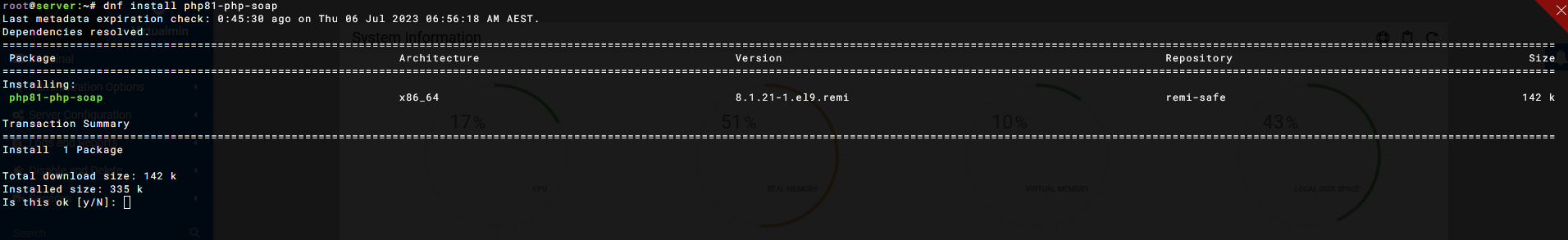

what do you mean seeing php-cli? I see this
do you see the remi-safe repo?

When I did the apt install php8.1-soap it listed more things (packages) compared to your screenshot which confused me.
As an example is listed php8.1-cli and even php8.1-gd which I assumed should have already been installed.
I think it is how the apt words things since it said it was going to install it and it also said it was going to upgrade it.
