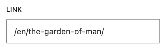

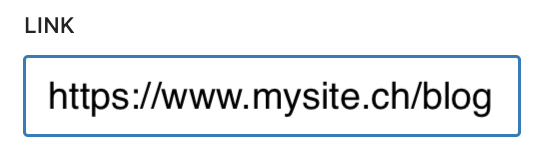

In the Wordpress interface the difference is the following:
What WordPress uses in navigation menus or other internal links looks like this:
Or for pictures:
https://www.mysite.ch/wp-content/uploads/2025/05/Garten-DE.jpg
If you remove the “https://www.mysite.ch” and keep the rest of the url starting with the first slash after the domain name then the links work irrespective of the domain name:

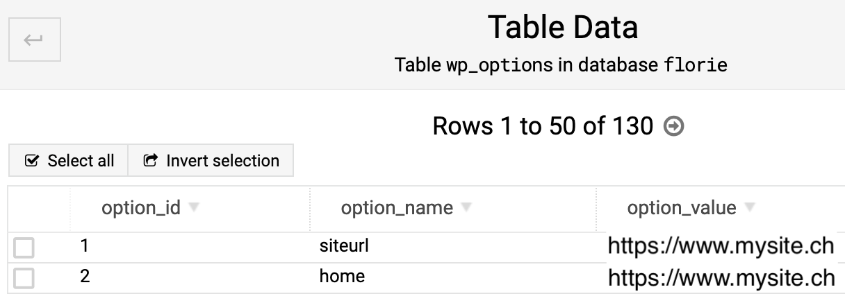

But the two entries in the WordPress options table for the keys “home” and “siteurl” that define the site root need to be left unchanged, which would normally be the case since they don’t end with a slash, so they don’t get replaced by the search-and-replace:

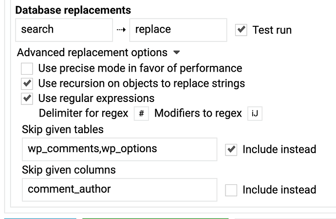

@kamyar.hu Alright, I’ve just added basic find and replace functionality. Now I’m wondering if we need more advanced options like --skip-tables, --skip-columns, --include-columns, or --regex-flags?
Example (with new not yet released WP Workbench Manager):
And of course, we’ll use the same API to fix all links when cloning…
This looks amazing Ilia. I have rarely needed advanced search and replace options like -skip-tables , --skip-columns , --include-columns , or --regex-flags over years, and in those rare cases a WordPress plugin did the job. So it might be useful for some people at specific moments for sure, but I personally would not consider it as essential (needed).
If the automatic search and replace works during the cloning, replacing old domain with the new one in all the database that would do the job for me.
Thanks!
In this case, I would rather create an advanced section in a collapse. Thanks for the heads up!
I haven’t done it yet, but I will pretty soon.

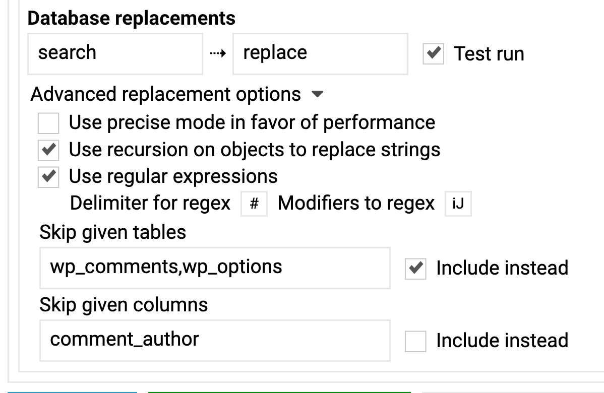

Unless anyone has better suggestions, it will go like this for search and replace:
There is also --network flag to search/replace through all the tables registered to $wpdb in a multisite install.
And, --all-tables-with-prefix to enable replacement on any tables that match the table prefix even if not registered on $wpdb.
