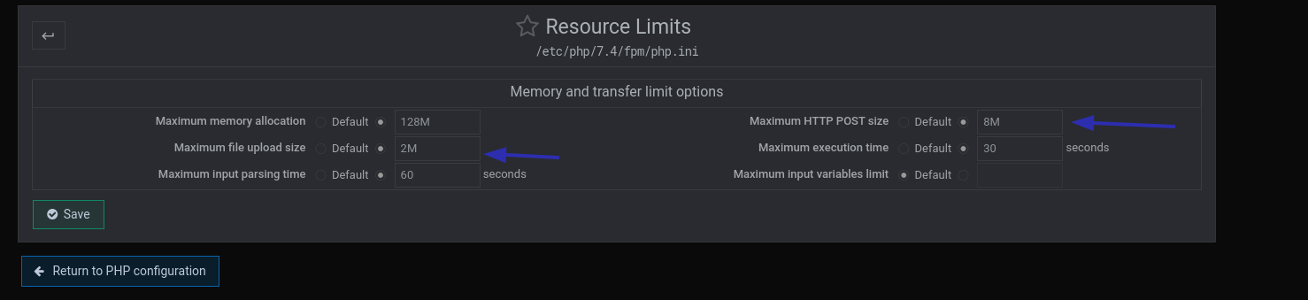

Under webmin
So there is 2 settings, this is global setting BTW.
if you’re using php-fpm (check virtual server → Server configuration → PHP settings), then go to virtual server → Services → php-fpm configuration → resource limits.
adjust ‘maximum file upload size’ and ‘maximum http post size’ to whatever eg. 8M.

You will probably find that those settings are overridden by individual domain settings.
Select the domain, then Services, PHP-FPM Configuration, Resource Limits.
You will notice that the line just under the title Resource Limits ends in a long number.conf which is for that specific domain.
Same under the individual domain setting
