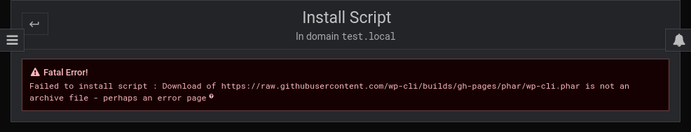

Wordpress fails to install
Have you ruled out Proxmox firewall issues? By turning off the Proxmox firewall?
Yes. I also use VirtualBox on a linux host with no firewall and the outcome is the same. All has been described above, multiple times.
No idea then … it appears to work for everyone else that said i did try to mirror your system and install the software you are trying to install and it worked fine… but who’s to say my tests are valid ?
Indeed, this is no longer a professional operation. Being semi retired an’all. None-the-less, I do have some high end $eriou$$$ server hardware kicking around, with one sad, wrinkled (read seasoned) burned out nerd posing as the owner/current custodian.
Also - it could be the provider yanking my chain too - all is possible at this stage. This has now gone into Twilight Zone territory me thinks.
I just installed Ubuntu on a VM at home. No real DNS, aborted the Virtual Server installation that stalled at validating SSL, cuz well, it wasn’t gonna happen. So half axed install of VM and the virtual server and the WP script still worked on my wonky, half setup domain.
There is clearly something’s wrong with SSL/TLS handshake, as connection gets unexpectedly closed.
Do you have ca-certificates package installed and updated? Is the time on the system set correctly?
Hmm, I have not installed any certificate software or certificates on the container when it was created, nor have I installed them on the Virtualbox instance of Ubuntu Server. If they are installed then it has either been installed by default or by Virtualmin in the installation process. Checking on if it was installed and yes it is (see below)

cURL error 56 - No change

Further, it still baffles me when the same command in a terminal succeeds where as in the install script - it does not.
The error above from the wp CLI command indicated it was unhappy with the domain name in the email address you used. Not Virtualmin. You keep pointing at Virtualmin, when everything I see so far is unrelated to Virtualmin.

It’s not a complex setup to mirror, 1 proxmox, 1 debian or ubuntu container, 1 NIC connected directly to the router and everything is a fresh install, no tweeks, no firewall, no DNS servers or UBound in between, the only difference is my internet provider.

No need to be defensive… I’ve already ruled out Virtualmin as the suspect because I tried a pre-made turnkey linux container which does not use virtualmin.
It is strange though that in all instances, the command works in a terminal but not in the script. We are just now clutching at straws. Sadly though, whatever it is that is ultimately causing the issue, also affects Virtualmin too as well as the turnkey solution. That’s the rub and I love Virtualmin - so please, don’t get me wrong. I would dearly love to sort this problem and continue my life long path to oblivion with Virtualmin at my side.

Something is messing with your network connection. It isn’t enough to install the tor package; you need to reroute all local traffic through Tor
There are other ways to do it. Furthermore, you could try strace or tcpdump to see what’s really happening. There are different moving parts, so you need to be patient, taking educated guesses.

Installing tor seems like a wildly unrelated thing to do. tor is for routing around intentional censorship and insuring privacy, it’s not for solving intermittent network connectivity problems! It will just mask those problems and move them around and make them harder to solve.
I don’t think installing tor is going to do anything useful for you. You have network problems. You need to solve those network problems.
It depends on the origin of the network problem. I suggested using it just for testing purposes.
