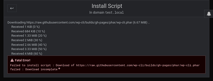

What’s the problem really? The email address you have set in virtual server configuration is invalid.
Was the network problem solved?
No, not solved - still.
It was a complete fluke that it installed.
I tried again installing the script on another Virtual Server… It’s back to its usual tricks as per my original posting.
I’ll pick this up again later - For now, I’m done.

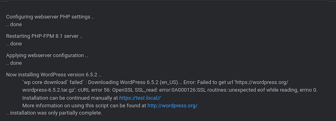

Thanks for digging those 2 curl issues.

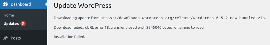

On the first, it appears that it pertains to curl totally not working with Wordpress. On my existing sites, I don’t see the issues reported, it’s all working fine apart from the update Wordpress from inside the Wordpress Update screen, in addition to the Wordpress install script in virtualmin.
I will try to create a debian and ubuntu Virtual Machine today to see if it is an LXC issue.
For the second.
Nope I tried installing pieHole in a debian LXC using his commands, but everything went fine - installed pieHole no issues.
I did also - just for “sheets and giggles” change the DNS setting in my router for googles DNS instead of using the internet providers DNS and rebooted the proxmox host and VM’s/Containers. No change. I did not think for an instant that I had DNS issues but tried it anyway.
Further, to remind you that my linux desktop running Virtualbox and Ubuntu Server 20.04 with Virtualmin is also having the same issues as the proxmox LXC’s (Debian or Ubuntu). So currently I’m leaning on the side of, it’s not a proxmox or LXC issue.
Well, back to square one.
I will try now to create a VM.

We can help to work it out. Is there anything useful logged in /var/webmin/miniserv.error
when this error happens?
Also, can you run some more tests for us?
Can you edit /usr/share/webmin/virtual-server/scripts-lib.pl
file and replace lines 441-444 with:
my $dtemp =
&backquote_command(
"curl -sS --request GET " .
"--url https://$host$page ".
"2>&1 </dev/null");
write_file_contents($temp, $dtemp);
Example of how it should look like afterwards:
Restart Webmin by running /etc/webmin/restart
and try again – does it fail in the same way or it’s reliable now?
Is your domain test123 as this is not a valid domain name
it may not be valid publicly, but it is valid locally and virtualmin has been happy with this since the beginning. But please, don’t get hung up on this fact. Whether I use a valid domain and tld, it performs the same.
Great - thanks.
I’ve just tried installing a turnkey linux install with Wordpress and it’s defo not Virtualmin - like you say.
I get the same error from Turnkey too
Soooo, that’s exhonorated Virtualmin… but whatever is causing the problem is also affecting Virtualmin.
I’ll give those things you suggested a try. BRB
Alright, it would be interesting to figure out.
As all this happens within an LXC container, are there any resource limits imposed and perhaps hit when an HTTP download occurs? Did you check kernel logs?

Well, I’ve installed your edits and…
No resource limits in terms of disk or RAM… I don’t know what other resources you allude to other than the php limits in php ini, but your script sets those minimum limits anyways - from what I can see.
You either installed it incorrectly or forgot to restart Webmin.
Checked the logs in webmin and /var/log - nothing in there I can see.
Here is the result - AFTER I rebooted the VM - my bad… sorry
This sounds like a home setup? Is your provider, lets say it politely, messing with you? Some do unethical things to people trying to run servers and actually use the bandwidth they pay for.
