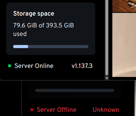

When playing around with Code-Server, and now Immich, I have noticed that the web socket connections fail unless I modify the sites-available/MyDomain.conf files through Edit Directives. This happens when using Edit Proxy Website, as well as the Proxy Paths options. I found a solution here, but there were no replies, and no explanations on why this was happening.
I’ve added RewriteEngine on to the Configure SSL Website directives, and thus have the websockets working in Chrome/Brave. When I was just worried about modifying the code-server directives, I simply used Brave; as mentioned, I don’t like hand changing files. However, this really isn’t a viable solution since I prefer Firefox and now I can’t get Immich to properly connect sockets without modifying the RewriteCond %{HTTP:CONNECTION} Upgrade [NC] code as well.
The pic below explains my issues. Server Online is a Brave window, Server Offline is a FF window.
Please explain the following: Is this a bug? Is there a reason the RewriteEngine directive isn’t in the SSL config? Is manually changing the Upgrade line the proper way of doing things, or should I do something else? Is there a better way to handle anything I’ve discussed?

Sorry guys… work weekends so getting back to the forums is sporadic. @Jamie is correct I believe. There is a web socket checkbox in the Proxy Paths section of VMin.
However, without adding RewriteEngine on in the SSL config, the web socket connection doesn’t work for any browser. In addition, I have to alter the following to get web sockets working in Firefox specifically. However, after making this change the connection works in all browsers I’ve tried.
 RewriteCond %{HTTP:CONNECTION} ^Upgrade$ [NC] to
This is the case when using both the Proxy Paths configuration with the WS checkbox checked, as well as using the Edit Proxy Website (where there is no web socket checkbox).
