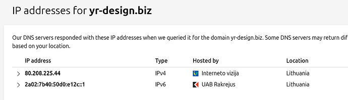

May some clue here? Seems my hosting servers have two different registration for their networks!!!
