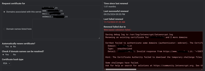

The LE certs fail giving to LE an http file as a response instead of the normal response, so probably the wrong redirects are the problem, but I do not know how to solve it.

@urbaman,
Let’s Encrypt is failing because it’s trying to setup a cert that includes:
If you have not setup all those sub-domains (www, mail, webmail) pointing to your server, LE will fail. If you don’t intend or want to at this point, just choose “Domain names listed here” and enter the versions of your domain that “are” pointing at the server (ex. domain.com and www.domain.com).
Then generate the cert again.
Keep in mind, LE does have a daily quota, so if you fail too often you may exceed the quota and have to wait to try again.
Hi @tpnsolutions
I do have those DNS pointing to the server. I have pretty much the same settings for the working domains (with way more subdomains to cover by LE) and the ones not working.
I also leave " Check if domain names can be resolved?" to yes and they are.
I only see those default unchangable redirects are different between the working and not working websites.
