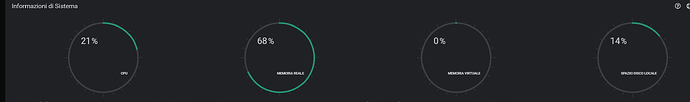

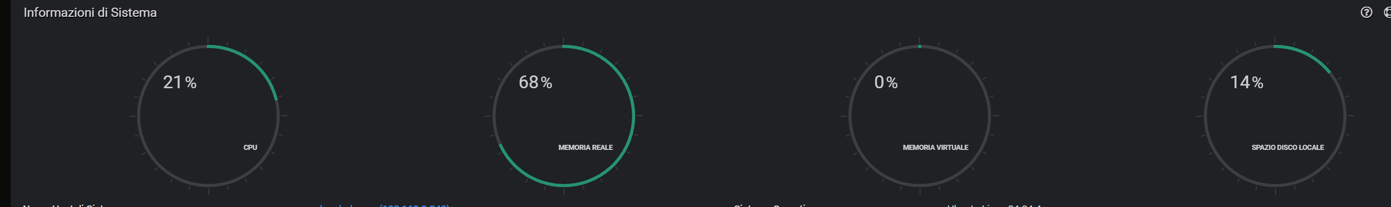

Not the issue, server has a lot of memory and less then half is used, virtual memory is almost 0
