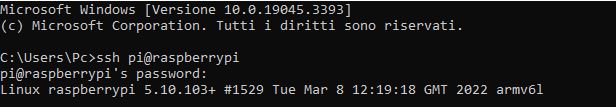

is that even possible? Is it even listed as a class A?
Sorry i don’t know, I’m a bit ignorant in this area, but this is what I’m using
Cattura
Webmin, not Virtualmin mate.
If OP is just using Webmin, as appears to be the case, it runs on just about anything.
