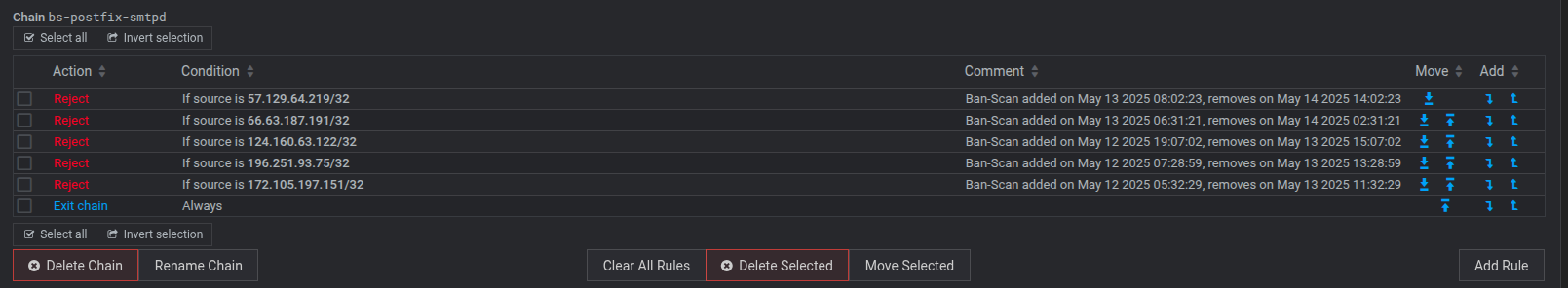

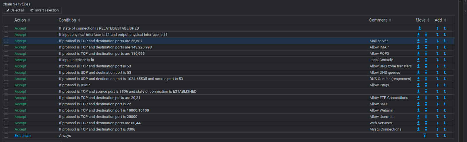

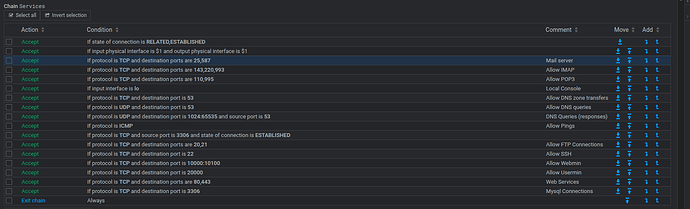

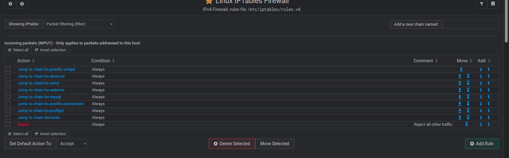

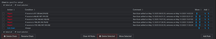

as there is an iptables module within webmin which will, perhaps, display your ufw rules. Personally I ditched firewalld & fail2ban in favour of something I code myself, here is an example of the iptables module display
input rules
services to allow
sample data
