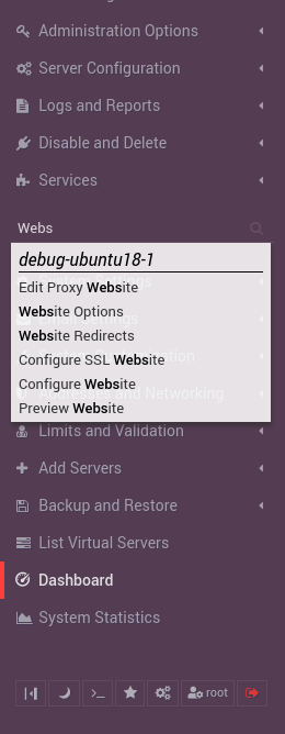

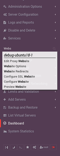

You can change PHP version and execution mode from UI. There is no need to use CLI, unless you have to. Type in autocomplete search bar for Website options and PHP.
