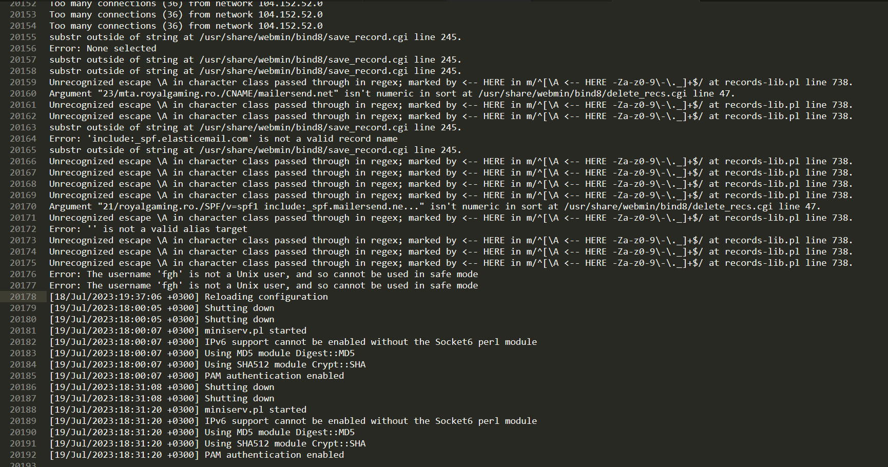

Here is a screen from miniserv.error, spamming something till i restarted the webmin.
Before restart:
After restart:
What page did the problem happen on?
The whole webmin page(site:10000 , dashboard/all) stopped to respond, with blank black web page error 500(not internal), the web page wasn’t accessible anymore, i think app was crashed due that spamming thing from webmin error log

in error log have again that spam with „too many children (51 > 50)”
