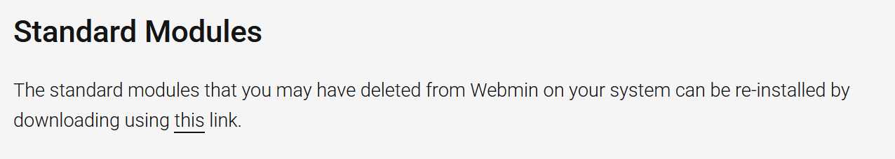

If you have the latest Virtualmin repositories, you should just run apt-get install webmin-nftables or dnf install webmin-nftables to install it, instead of downloading it from the Webmin website. Also, if you have the full version of Webmin installed, the module is already included.
OK, thanks. I hardly ever look to the modules section. I looked at a list in the webmin configuration > Modules > Export section (i can’t find a modules list anywhere else) and saw no nftables item, so installed it.
I see a “Linux firewall” item now, so overlooked that. The download is called "nftables"Does reinstalling mess things up? Did I install something else that should not be there? Not a big problem as I am testing a new install without anything critical on it.
Ilia should update the documentation to cover the weird new minimized Webmin, I guess, though that Webmin package is only found in Virtualmin repos.
But, it’s always true that you should use your system package manager when possible. Most open source software doesn’t try to keep up with which distributions have packaged their app and may provide generic installation instructions (building from source or npm/npx or pypi), but if you can get it from your system package manager that’s always what you should do, absent a very strong reason not to.
