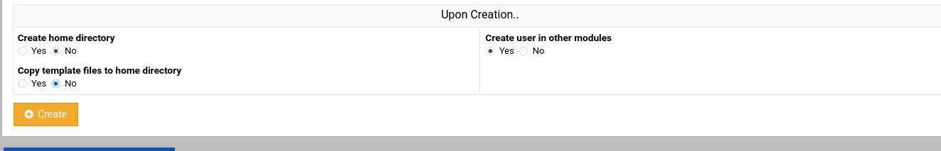

did you use webmin to create the user ? I tend to create the user on the command line (adduser) then add the user to sudo (usermod), the users created with that method work as expected. However I just tried using webmin to create the user adding the same parameters (secondary group sudo) using webmin → system → users and groups → create user and this also worked as expected
