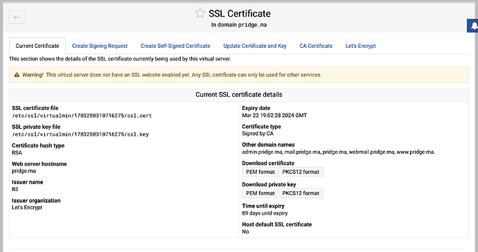

Warning! This virtual server does not have an SSL website enabled yet
Webmin version 2.105
Usermin version 2.005
Virtualmin version 7.9.0 Pro
Theme version 21.09.5
Warning! This virtual server does not have an SSL website enabled yet. Any SSL certificate can only be used for other services.

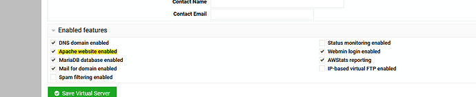

hello everyone please if I have this message and I can’t shout an ssl which what I should do thank you
For this message to go away you need to enable Apache website enabled feature in Edit Virtual Server page.

Did you tick this option.
yes Mr im sur

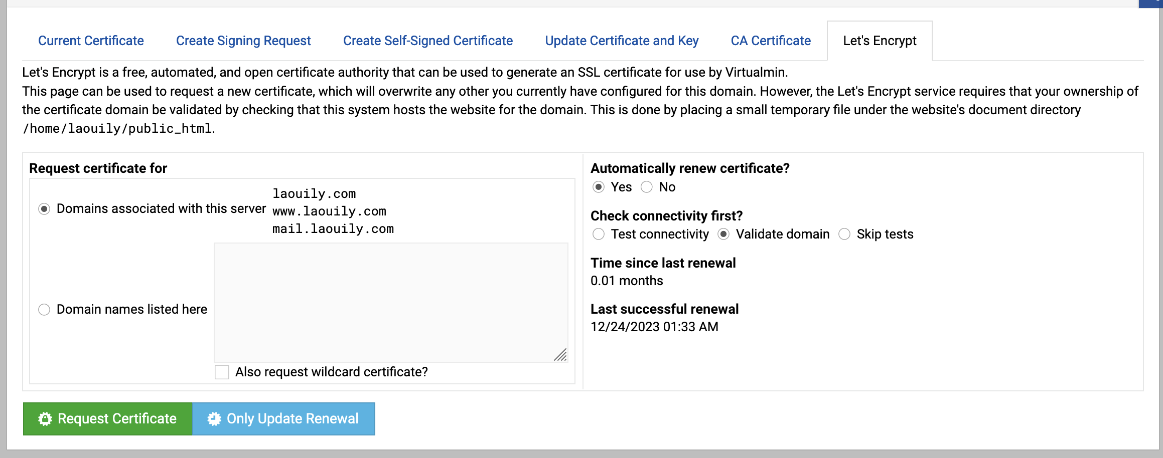

Try going back to Lets Encrypt and requesting a new certificate and see if you get any errors.
now i go to run this solution but i have the problem only with 3 domaine name

No, I have absolutely no idea. The message shouldn’t be shown if a virtual server has website feature enabled.

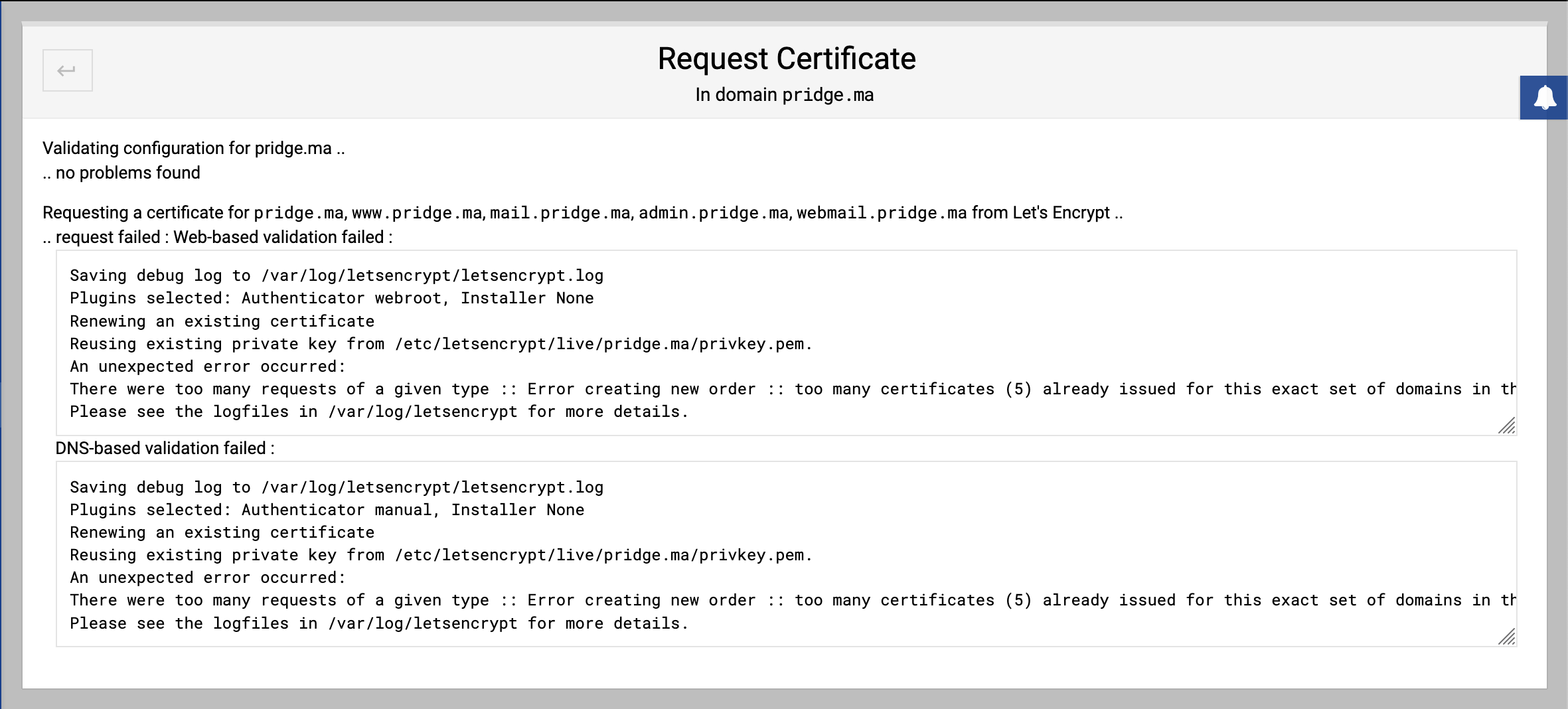

This error indicates that the certificate request has failed due to reaching the rate limit. Although, in this case, a working Let’s Encrypt certificate should already be installed, and therefore nothing else needs to be done any further.
