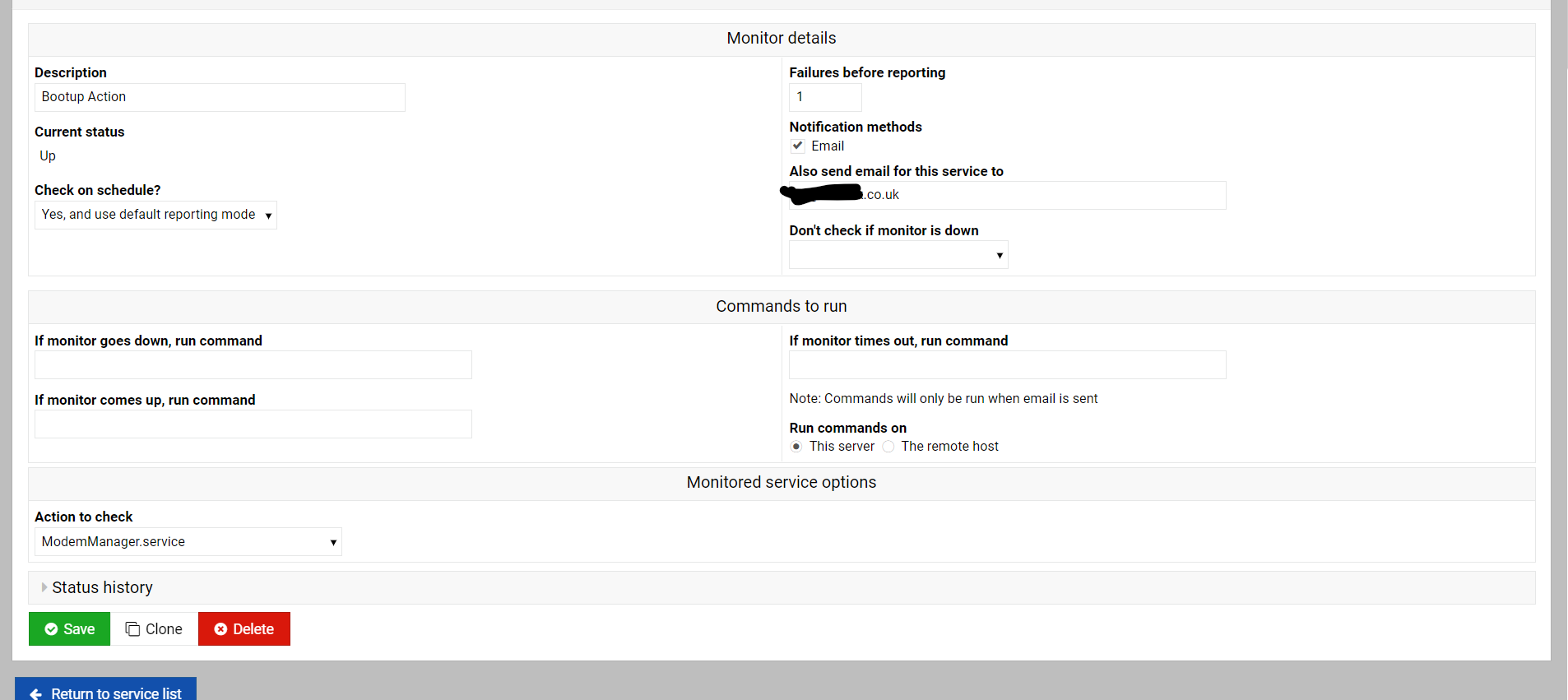

Thanks for that. But I’m still not seeing any emails. I selected the default ‘Action to check – ModemManager.service’ because that seemed as good a service to check on reboot as any and it does get started automatically when the system boots. I tried ‘No’ for ‘Check on schedule’ because I want the email only when the reboot happens, not on some schedule. When that didn’t result in any email, I selected ‘Yes, and report on status changes’ and enabled Scheduled Monitoring but received no email for that either. I have no idea if I should enter any commands to run, so I entered none. Clearly, there’s something on the Edit Monitor for Bootup Action page that I have omitted or entered incorrectly, but I don’t know what. What am I missing?

Over a period of an hour or so, I tried both ‘No’ and ‘Scheduled’ but the monitor doesn’t seem to run unless I enable Scheduled Monitoring, when it runs every 5 minutes. Even when it DOES run, it fails to see a change in status because the service is always running – Webmin never sees the service when it’s down.

Bootup Action does not do what you think it does. It is not checking for a system boot, it is checking the status of a given service (ModemManager.service in your case), which can change state in a variety of circumstances, not just during a system boot, and I’m not at all confident that it would trigger on a reboot. See “System->Bootup and Shutdown” for the services this action can monitor (and it relies on the OS init system to tell it whether it’s up or down).
I have my doubts about this being a reliable method of detecting a reboot, because Webmin and the status monitoring job may not start until after the service you’ve chosen to trigger on, so it may miss a state change. And, of course, since the service (the “bootup action”) can be stopped or started outside of a reboot, it is also likely to give false positives.
